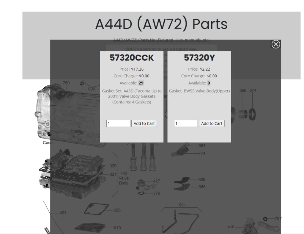

    @Glamisman You are the man! I apologize for any confusion lol. Yesterday was a long day and I was running on fumes writing that post. From my understanding the A44D and the A43D are virtually the same mechanically. So the manuals should be good for the A44D (which is what I have) as well. Thank you for sending this over, I will be trying to get ahold of the gaskets today to try and rebuild this weekend.

    Turns out Toyota has discontinued 2 of the 4 valve body gaskets... anybody have any sources to get them all?

    I hope your old gaskets are in one piece because you are going to have to match the new one to the old one.
