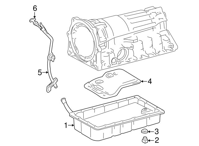

    Adding to this, for future reference:
    90341-10011 drain plug (#2 in pic)
    35178-30010 drain plug washer/gasket (#3 in pic)
    35168-60010 pan gasket (not pictured)
    35330-60050 A750E/F filter (#4 in pic)
    Checked with McGeorge Toyota; everything is still available, except the dipstick tube assembly (#5 in the picture). It's officially listed as "discontinued" on their site. That being said, I bet any number of Toyota wrecking yards around the country would have it.

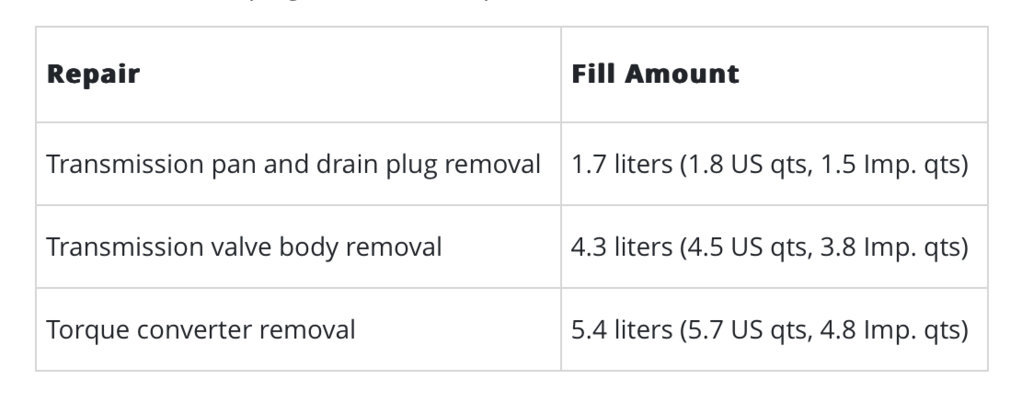

    We are going to have to call on @Dm93 for the 03’ Lexus 470 numbers.
    Because Chilton says 4.2 quarts. And that sound more like 06 4Runner capacity with valve body removal.
    Here what I show. I don’t trust the numbers. That’s a big difference between drain and fill for each.
    03’ Lx470
    06’ 4Runner
    BassAckwards[QUOTED] likes this.
  18. Jan 9, 2025 at 9:22 PM
    #118
    TnShooter
    TnShooter The TacomaWorld Stray
    Sep 2, 2010
    #42625
    21,106
    Deogee
    07' TRD Off-Road, Auto
    STOCK
    Ok……my fault.
    It clearly says “pts” in the image. (Pints)
    I’m a dumbass.
    There are 2 pints in a quart.
    So that’s 2.2 quarts for the Lx
    So the Lx holds a bit more?
    More is better……???
    Bolt it up…..
