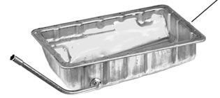

    I agree the normal fill and level check is not hard, especially with a Scangage 2 that displays TFT. That's not really the problem we are trying to address. The real issue is that if and when you have a *leak* you may not know it until your trans starts slipping, banging and acting up. And then you have no way to easily pour in some fluid to get you down the road and home. See my thread on a trans cooling line pinhole leak that almost left me stranded. It took me awhile to find it since it was slow and I was even thinking I had a bad solenoid or something. Luckily I wasn't too far afield and was able to drive it home and replace the hard line with no damage to the tranny. But it easily could have gone a lot worse.

    Which one is this? Some of the linked pans had the dipstick on the other side. How do we figure out which one will fit on a Tacoma?

    Sorry went to bed
    A750F for a 2003 land cruiser
    35106-60160 pan
    35013-60290 tube assembly
    35103-60220 dipstick
    Yes I have come across some pans that show tube port on other corner of the pan, just adds to the uncertainty

    Apparently the FJ has a trans dipstick, don’t know what years
    Why doesn’t someone jump on the FJ page and ask
