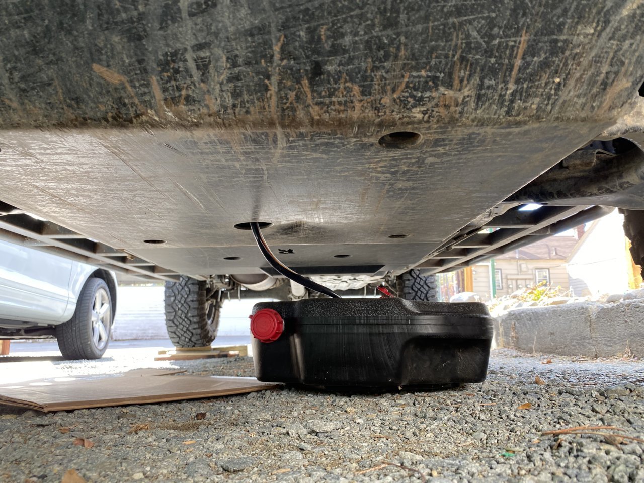

    Tell us you don't have skid plates without telling us you don't have skid plates.....
