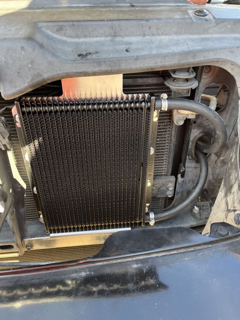

    Plumbed the cooler up first - I’ll be changing out those two worm gear clamps for some constant tension clamps soon

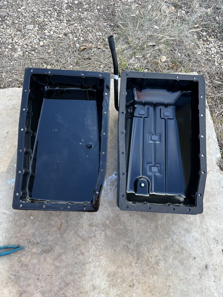

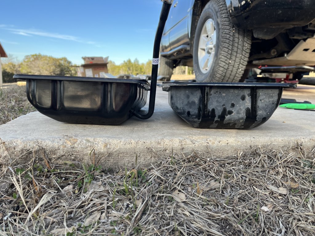

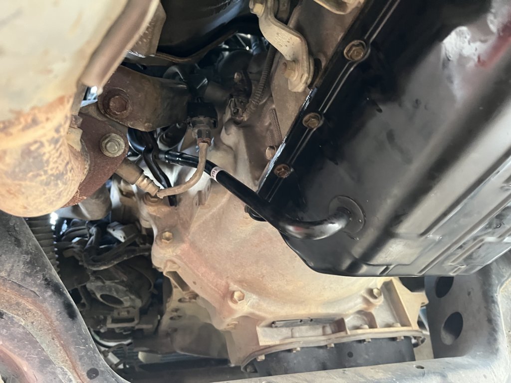

    Here’s a comparison of the pans. I got everything installed this evening. The dipstick and tube is from a 2002 and the pan from a 2003. From what i can tell, 1998-2003 parts should all work. Everything bolted right up but i had to bend the dipstick tube a little to clear the exhaust manifold stay bracket. I zip tied the tube to the valve cover but I’m going to come up with another bracket or way to secure it to the valve cover. There is an open threaded hole on the valve cover that would work well for this. Overall though, super simple swap. I changed the filter out today too and ended up using 4.75 qts and also 10oz of lubeguard platinum.

    Looks like it belongs there from the factory:D

    Factory parts fitting like factory parts.
