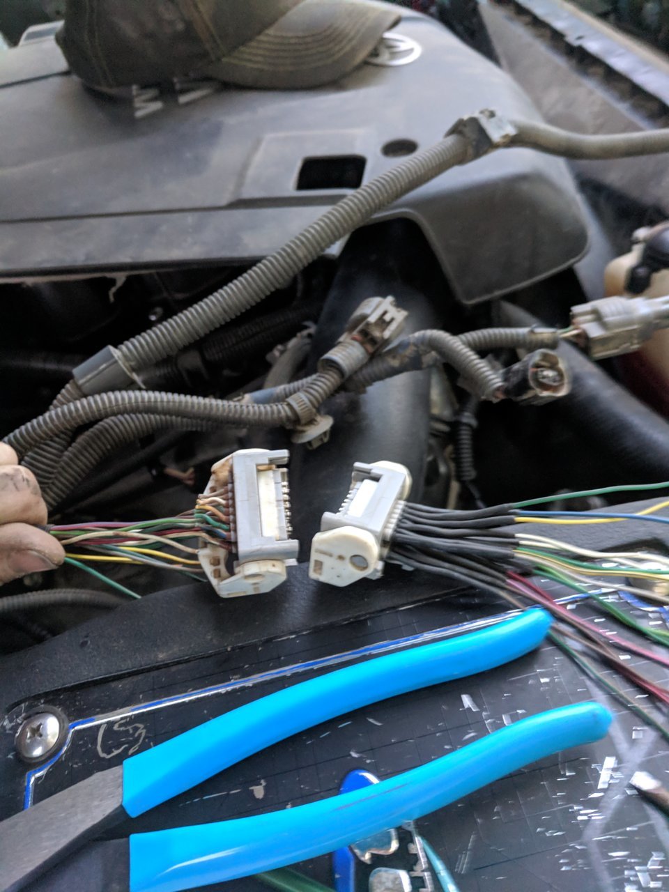

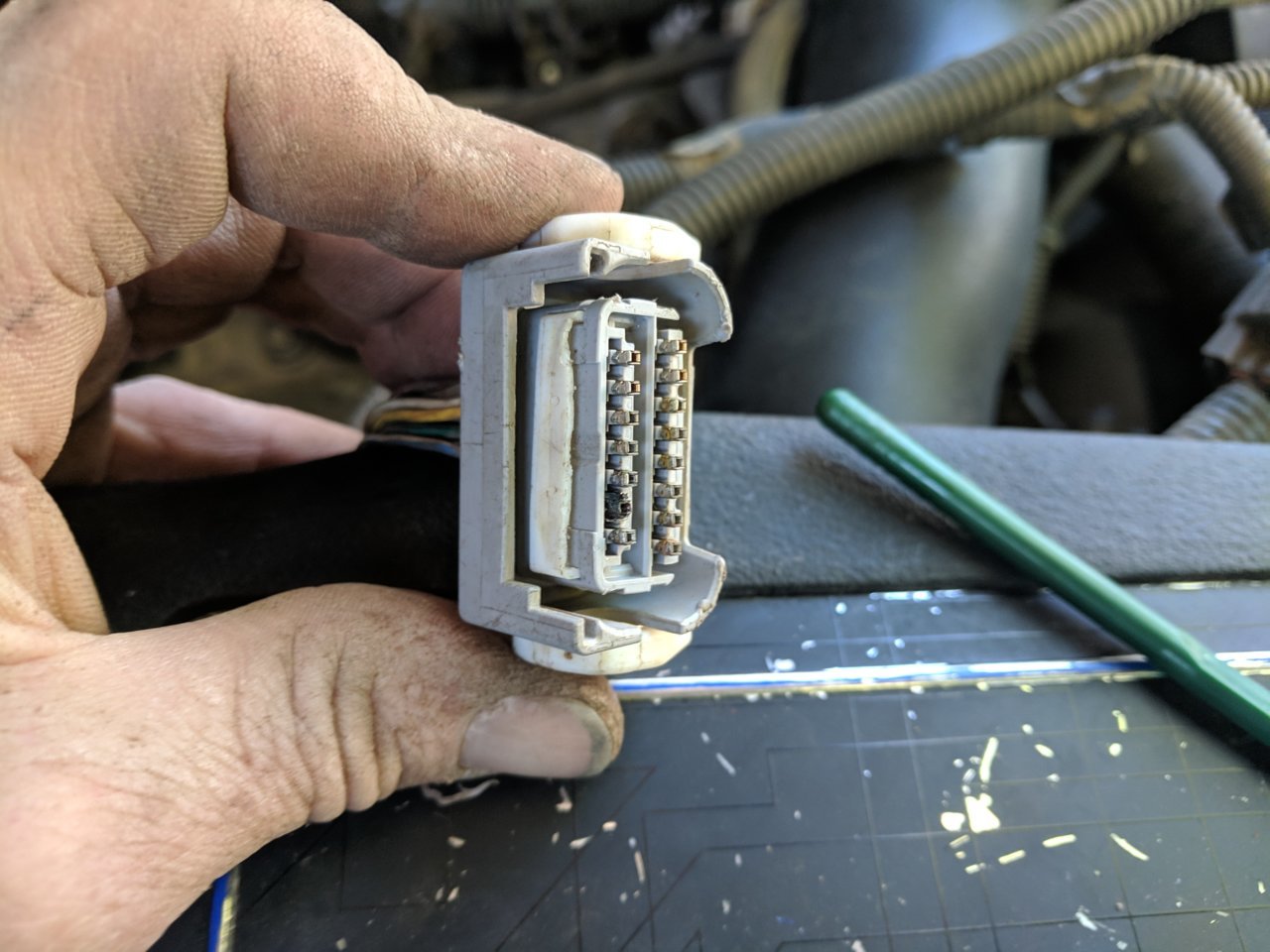

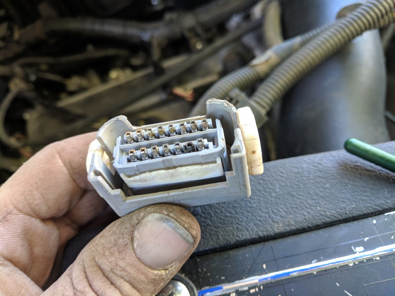

    Well found my issue rather quickly once I got the black cover off the plug. The pin go so hot in melted the plastic around it and burnt up. Pin #14, SLT+.

    Added 2 layers of shrink wrap to the wires to help reinforce them. Time to start cutting into the main harness! So much for waiting till this weekend. :notsure: I decided to go ahead and splice my replacement plug in, all the pins on my current plug looked worse for wear.

    That took a bit longer than I wanted. Final splice done, just need to put some loom around it and tape it up.
    Got it all back together and NO CEL!!
    :bananadance::yay::yes:
    One thing for anyone attempting to splice a new plug in, make sure your wire stays at it's fullest length. I got in the zone cutting and splicing and heatshrinking that I didn't notice I started getting shorter with my splices. :facepalm: Another thing to pay attention to is there are 2 yellow with black stripes wires and 2 brown wires. These are pin specific and can't be mixed up. I noticed this before I made my first cut, but completely forgot about it when I got the cutters in my hand. I ended up having to refer to the FSM wiring diagram and find which wire came from what pin at the ECU to what pin at the trans plug. I used a tone tester to trace the wire and was able to get it back to it's correct place. I spliced each half of the plug at a time. Spacing the splices out just past the one before it so there wouldn't be a big ball of connectors in one spot. Took about 10" or so to stager them. I used plenty of heatshrink so I shouldn't have a problem with water entry.
    I definitely suggest pulling the harness out and up to the engine bay, it made things much easier. It helps to have the wiring diagram of the ecu to transmission just in case you find yourself wondering which wire goes where. I probably could have completed this quicker but got ahead of myself and forgot to slide the heatshrink on before I connected the wires, and had to redo some a few times.
