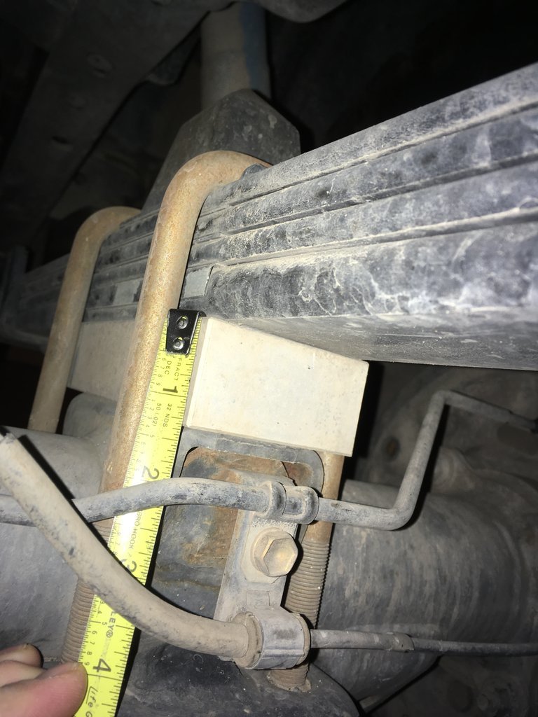

    It's 1 3/8" thick. So is that my lift height? I've always wanted to get rid of that Al block since I've bought it. Now the wife gave me the okay to spend some money, it's coming off!
    I've attached some pics to show ride height. And of block.
    Thanks again for the knowledge.

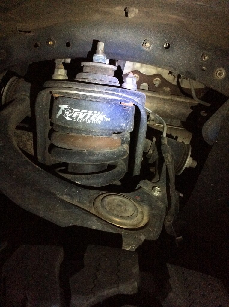

    I like this idea of the full pack. I have a 1 3/8" block on rear and a RevTek spacer, 5100s on front. Could I adjust the front to match the rear with a full pack replacement with OME Dakars? Would I need too?

    I recommend the Deaver 1.5" - 2" AAL from Headstrong Offroad. It gave me 1.5" rear lift, but I have a DCLB, so it may give you more. Keep in mind when you add Ride Rites it will add a little lift with the minimum air pressure of 5psi when unloaded. The lift will settle a little too after you get a few miles on.

    If you start lifting the front more you will def. have to look at aftermarket UCA's to achieve alignment. I'd ditch those spacers and lift via the 5100's too.

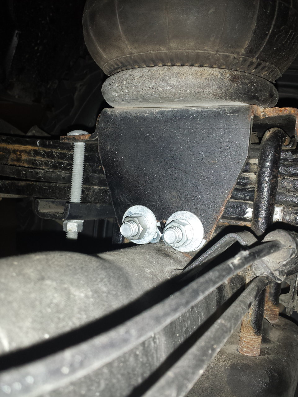

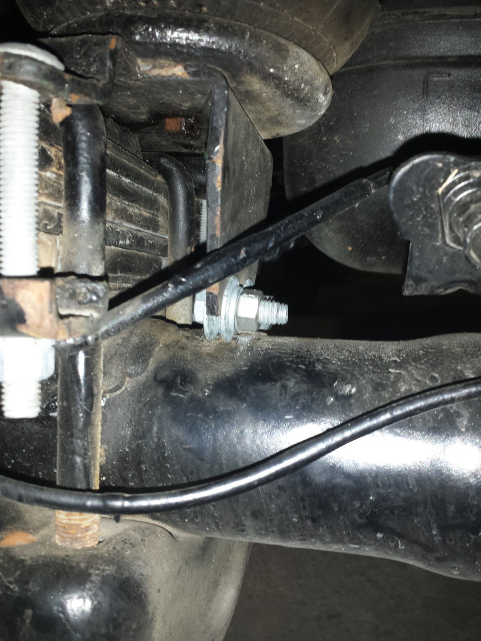

  15. Oct 26, 2017 at 7:10 PM
    shiftz
    shiftz Active Member
    Dec 16, 2015
    #172410
    25
    GTA
    '19 DCSB 6MT Sport

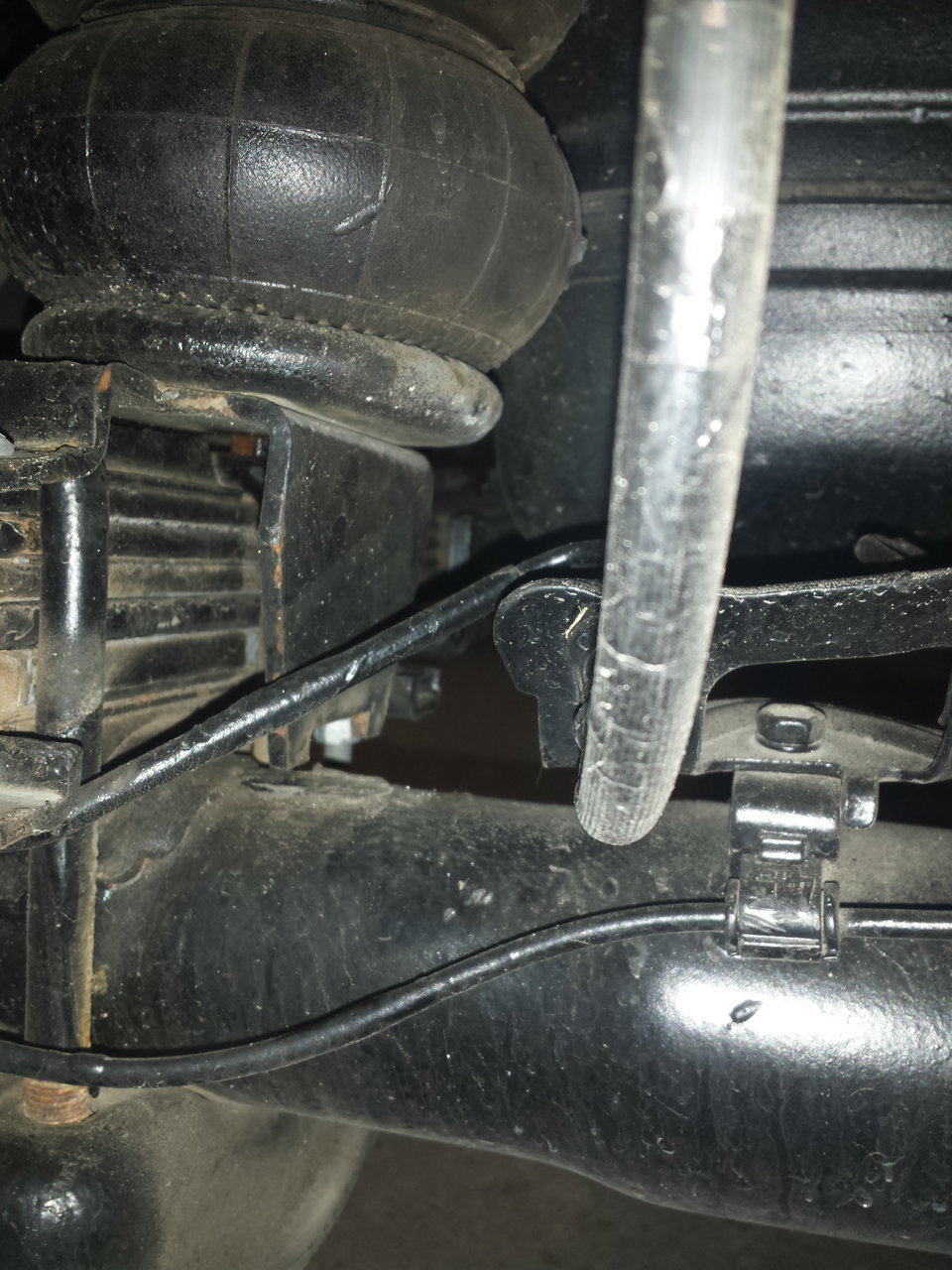

    I've been using bags as a lift for over a year and a half but really gets tiring rolling around at 70psi unloaded :).
    Finally decided to throw in a Tuff Country AAL and it feels like stock in comparison.
    Still need the bags for towing (but can keep the psi nice and low) and need that axle bracket extension as there is now a gap of about 5/8". I'm sure this will all bend to hell over time if I just leave it.

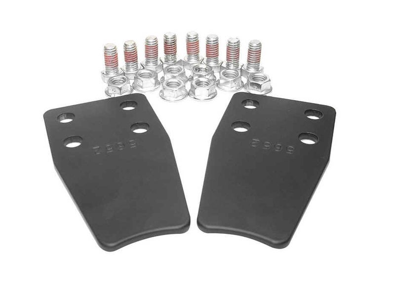

    I've found these:
    http://www.lowrangeoffroad.com/1-block-firestone-airbag-bracket.html
    https://www.truckspring.com/product...n-Brackets-for-the-Toyota-Tundra__RR2506.aspx
    They are not direct fit and will most likely need trimming.
    Both are approx. CAD80 shipped to Canada, not cheap for two pieces of metal plate that you still have to modify.
    Any, more economical ideas? If can source the right metal pretty sure I can cut these from scratch.
  16. Oct 27, 2017 at 11:22 PM
    #16
    shiftz
    Dec 16, 2015
    #172410
    25
    GTA
    '19 DCSB 6MT Sport
    Update: Threw in some 'temporary' 3/8" hex bolts, will see how she holds.
