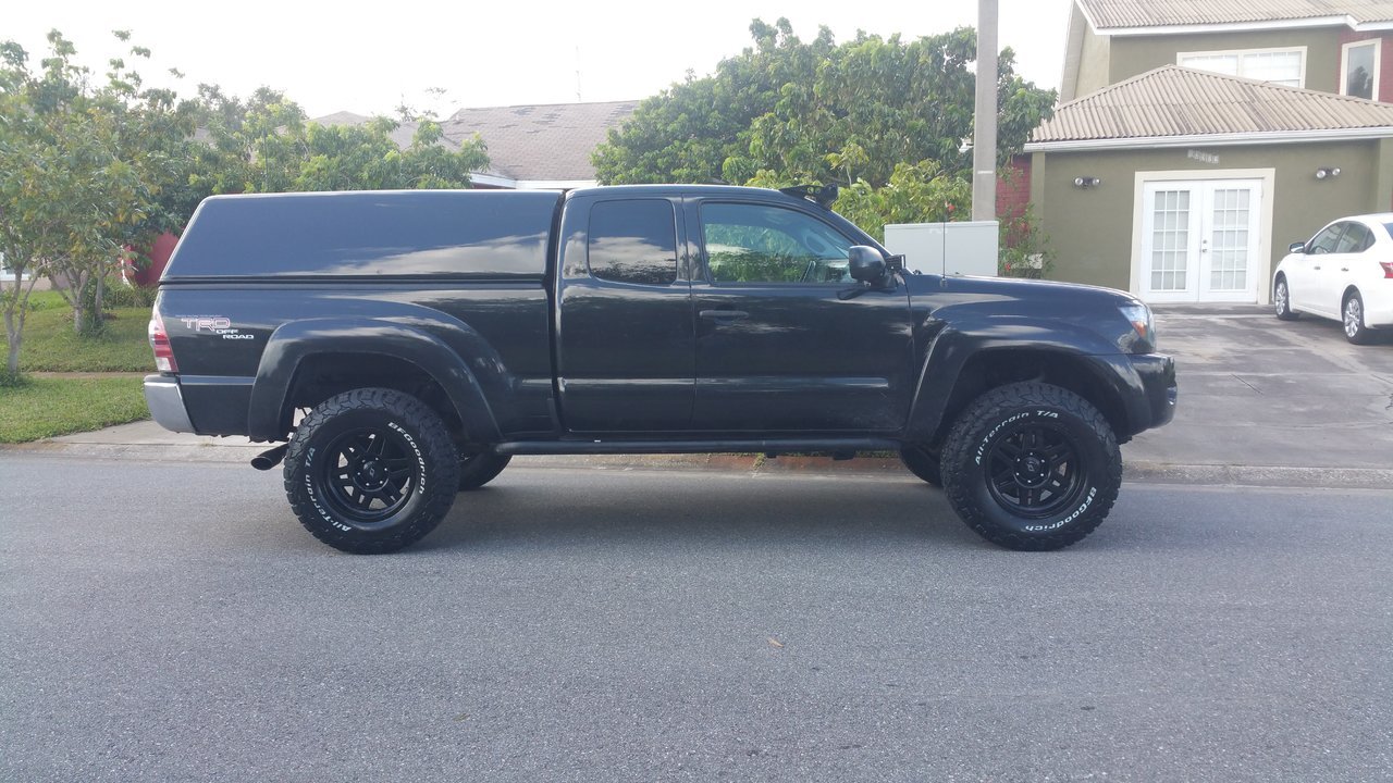

  9. Dec 26, 2017 at 3:02 PM
    #29
    Catfish21
    Catfish21 Well-Known Member
    Dec 18, 2015
    #172515
    2,049
    Stockton, Ca.
    Trd off road 4th Gen
    what wheels are those?
