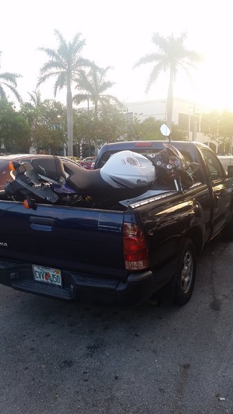

    So I just picked up a 2013 base model access cab 4 banger A/T. In about a month I am going to be driving it from NY to CA and will have a harley (550-600 lbs) in the back along with a bunch of spare parts and luggage. Including myself and passenger I should be right around 1200lbs which I know is pretty much the max for the truck.
    Looking for suggestions on which AAL to go with, I want to do something so the truck isnt sagging but I do not want to lift the rear end too much, at least for now.
