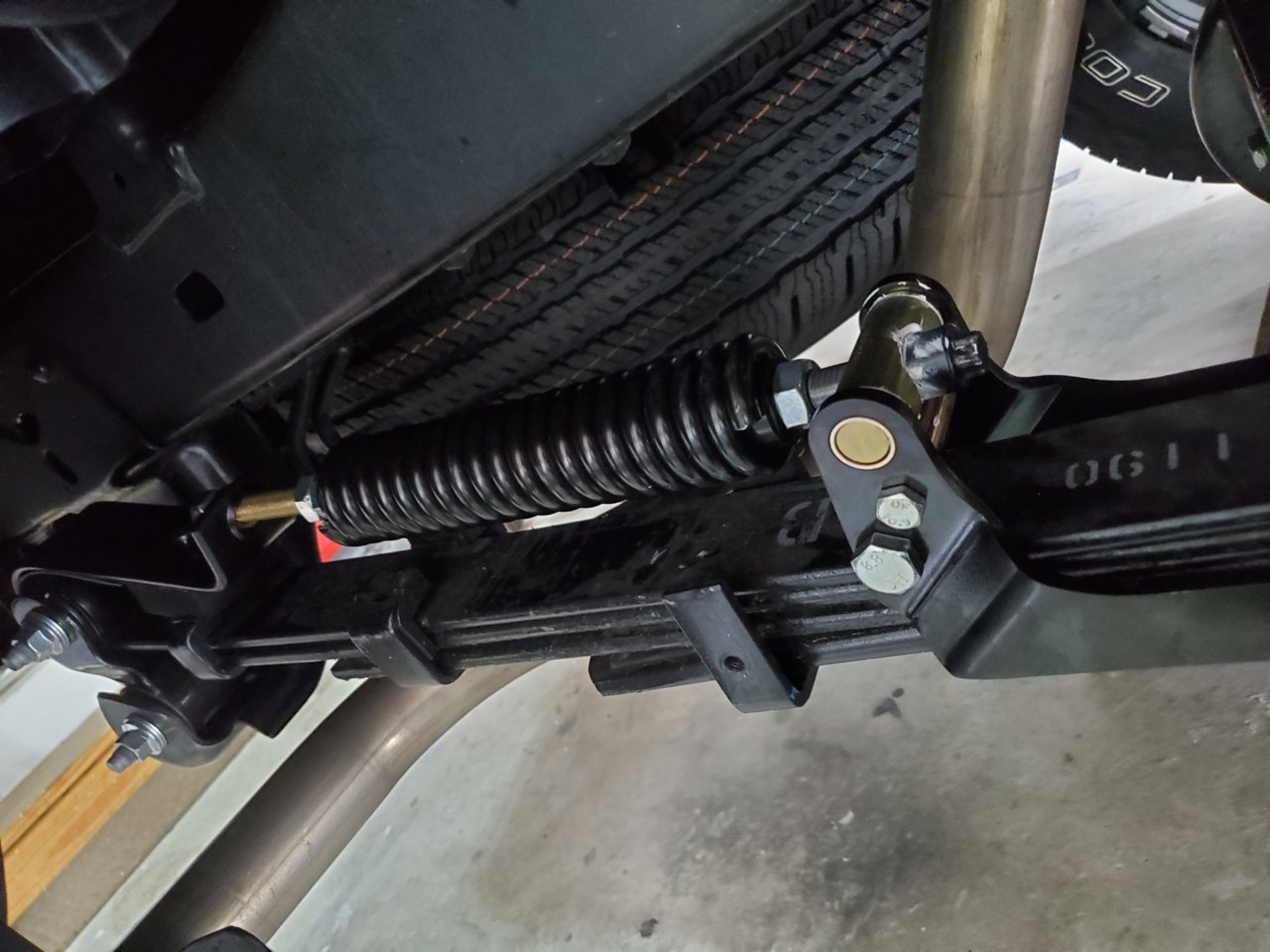

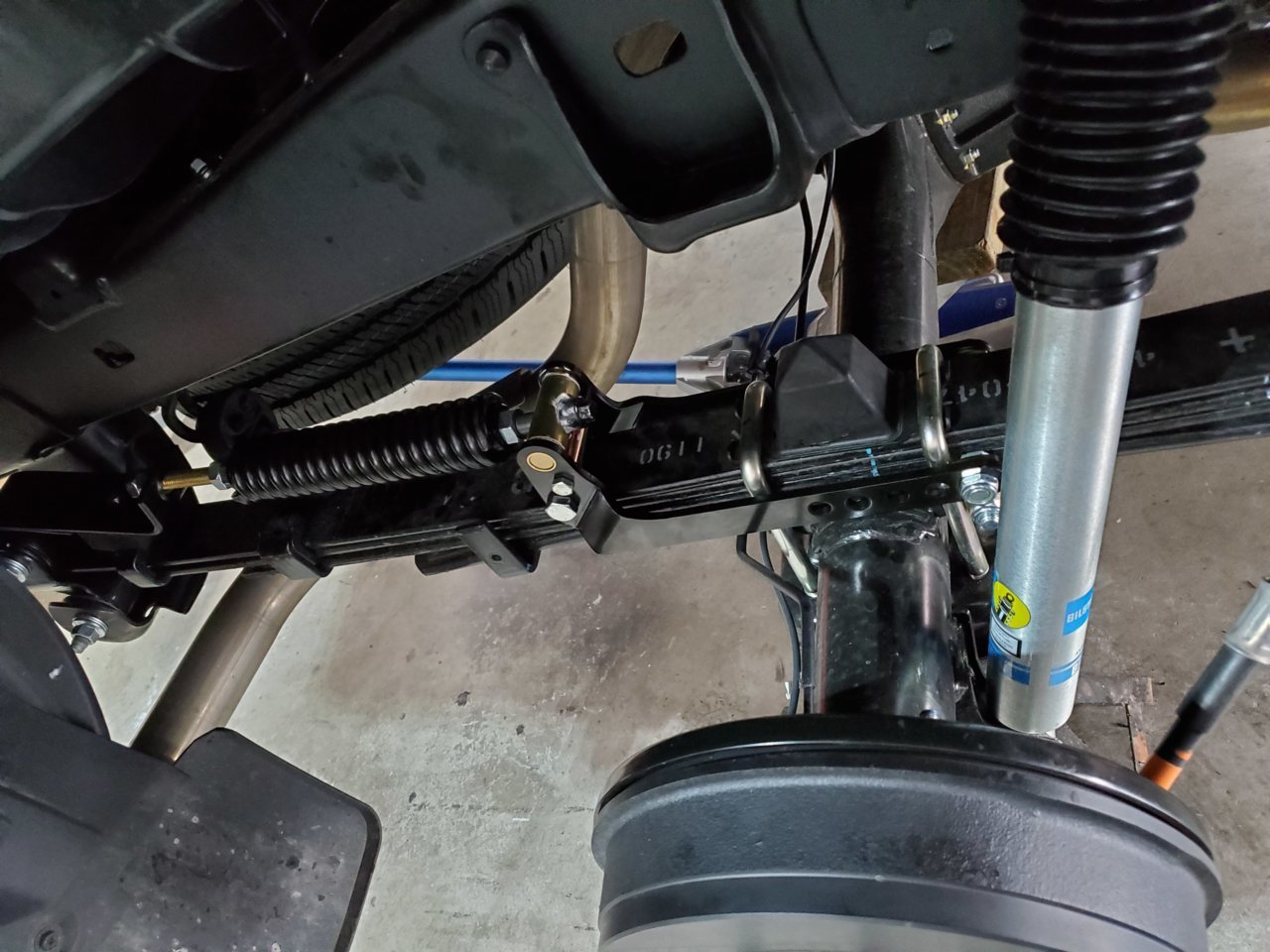

  11. Jan 6, 2021 at 8:11 AM
    Mike G
    Mike G Well-Known Member
    Aug 7, 2015
    #161269
    754
    2020 SR5 Tacoma DCLB 4x4 Red
    20200801_105836.jpg 20200801_112619.jpg The Roadmaster Active Suspension works great! I had Firestone airbags before and they definitely kept the truck level when towing, but they did nothing for the handling when empty.
    JCM138 and TacoManOne like this.

    1+ for the Roadmaster Active Suspension. Besides towing, it took care of a lot of the annoying problems with the Taco suspension...drivers side lean, sagging under load, and axle wrap up.

    They're called Roadmaster Active Suspension. There's really nothing else like it on the market.
