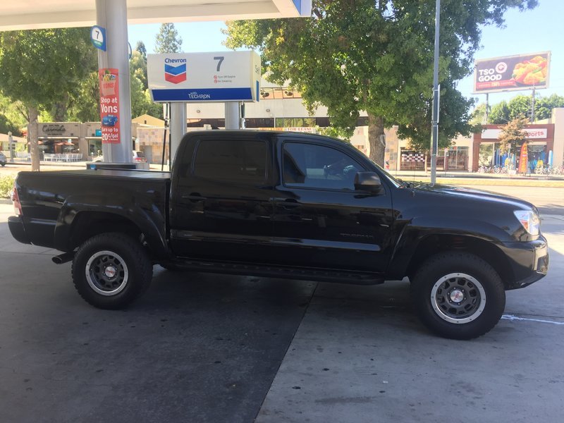

    Install complete, and what a difference. I know they say 1.5", but it seams higher. Truck looks a hair ass high, but that's probably because I am used to looking at it ass low. Threw a level on it, and it reads perfectly flat. Overall, I really like it. Once it settles just a bit I think I will be really happy with it. Now gotta get those spacers and lift the front. I think I'll get the 285/75 at the same time, since I'm going to need an alignment.

    Very glad I decided to remove the overload. Would have been too high with them.
