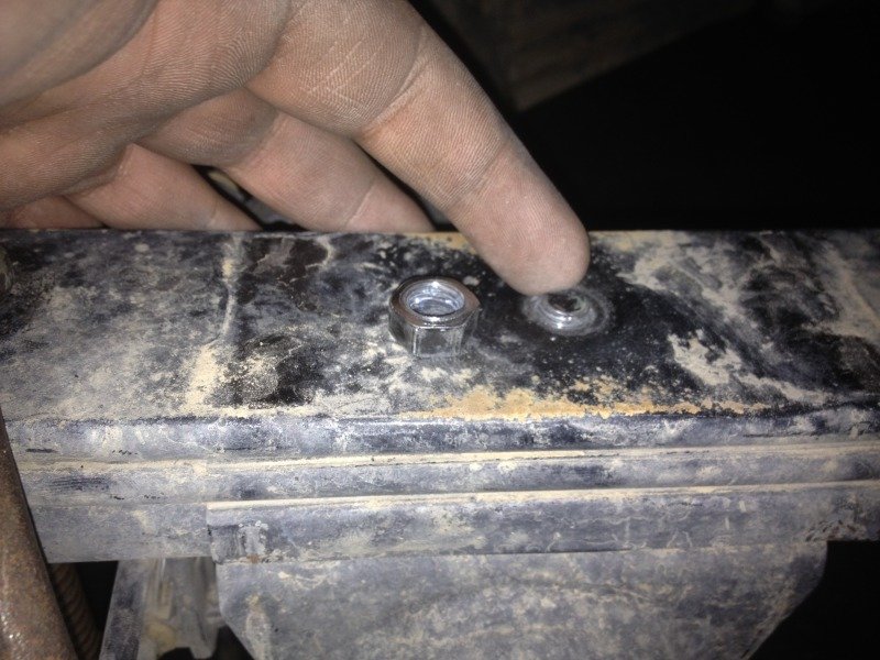

    This is as far as I could lift the truck with the axle on stands. My 7000lb jack was completely topped out.

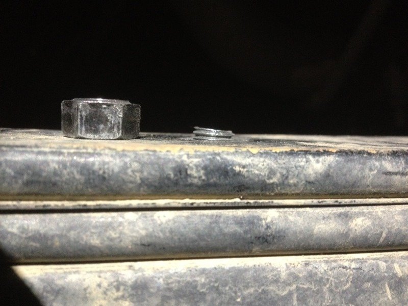

    This is the nut that came off the top of the centering pin, and the pin itself poking through the top leaf. This was as far out as the pin got.

    u need new center pin. looks like someone force that nut on by the looks of it.

    The AAL kit came with longer centering pins, so I'm not worried about the old ones being broken. I'm just trying to figure out how to remove it so I can put the new leafs in and tighten the thing back up.

    oh if thats the case lift the spring up or drop the axle and hit the pin out

    The pin needs to be removed from the bottom of the leaf pack just lower the axle housing and pull it out from the bottom.

    Jack up your truck as high as it can go, set jack stands, undo u bolts, droop the axle and then loosten the top nut that holds the leafs together. The nut should drop out. Then use a crowbar to get the aal.in, clamp the leafs, set the new extended screw, tighten it down and then reconect the leafs to the axle.

    Ok wow makes much more sense now that I know it comes out of the bottom...none of the DIY's mentioned that.
    I'll give it another try tomorrow at the shop, we'll have the truck on a lift and he's got some high lift jackstands we can lower the axle with.
