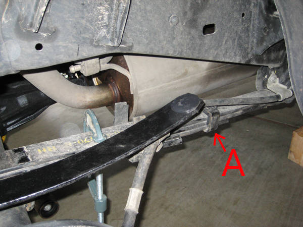

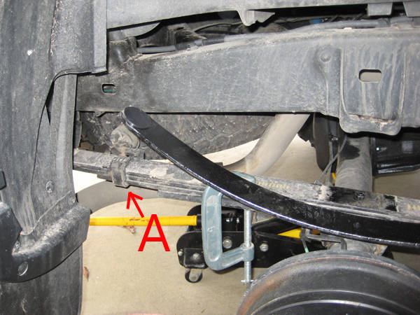

    Can someone help me out a bit? I'm going to install my 2" AAL to the TSB spring pack, but have a couple of questions...
    1. It looks like, once the AAL is compressed, it's gonna be too long, unless it goes inside the brackets (indicated by the red letter A). Is it supposed to go inside that bracket or is it supposed to stop before them? BTW, it doesn't matter which way I turn the AAL - it still looks like it will hit that bracket.

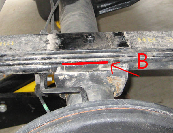

    2. Will the AAL go in the spot indicated by the red line pointed to by the red letter B?

    It does go inbetween the overload leaf, and the main leaves. "B" is correct placement. You can cut the AAL shorteto fit, but dont go too short. Keep it 1" from the bracket on the other leaves. The rubber peice should be able to be reattached. Take it off and see how it mounts to the AAL, then cut out a spot for it with your grinder. Toytec also sells an AAL for use with the TSB springs, if you want to return the AAL, and go with theirs.
