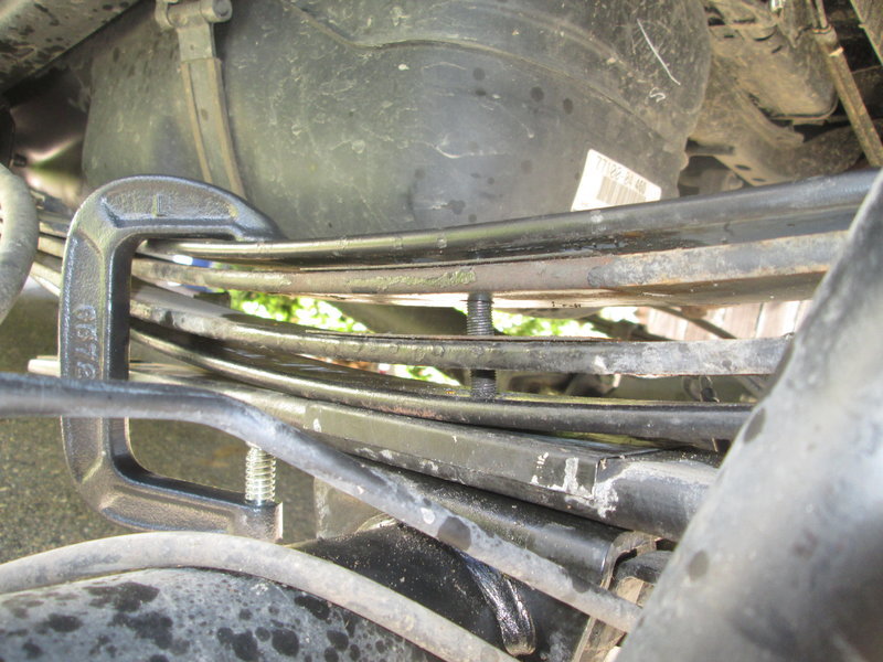

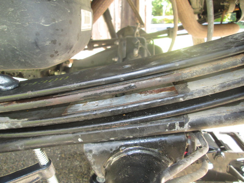

    I got them all in a row, except the top one. I never got the front bolt off the spring housing. It was just too tight.
    Anyone have any tips on how to get that top one to slide into place? it's too far back.

    I used a long 1/4" socket extension, when they are all relaxed, slip it in and then clamp them, should keep em lined up

    yeah it's hard to do without getting that front seat disconnected so you can take the whole thing out. the problem is the top leaf has slide back to the rear of the vehicle about half and inch and i can't get it forward. it's being pretty stubborn. even tried hammering it from the back.

    got it :bananadance:
