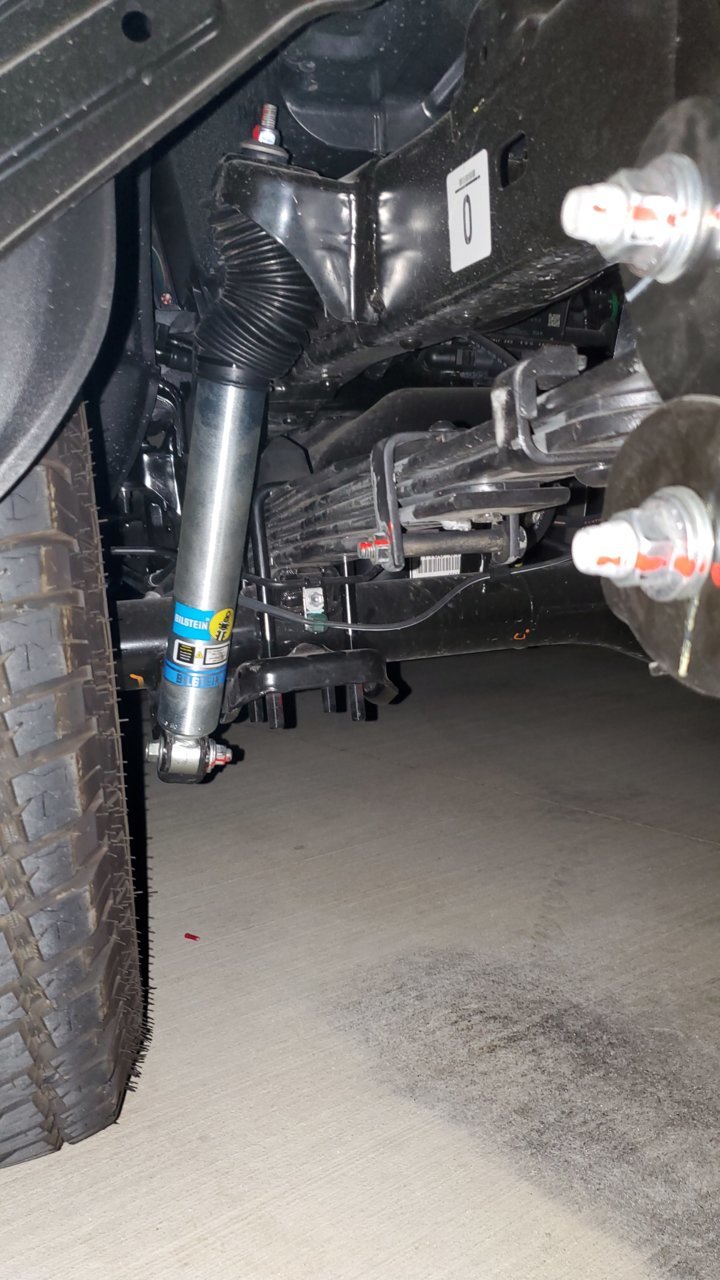

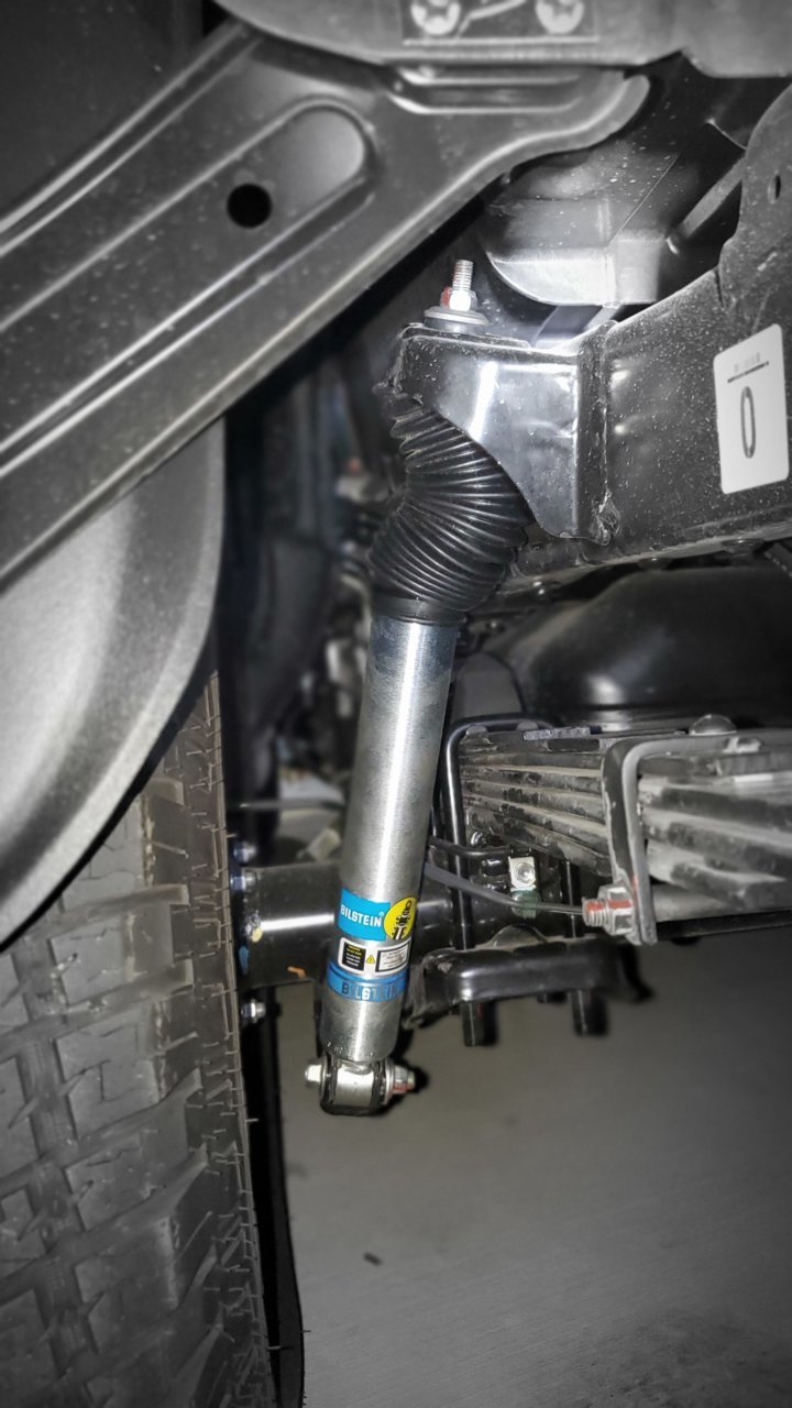

    Just got a lift on my truck today. 5100's front and back and an Icon AAL. Got home and was looking at the springs and they don't look right. What is wrong? Is the AAL ON TOP? I have 0 knowledge in this area.

    Yeah, looks like it’s mounted at the top of the pack and it’s facing downward, so doubly incorrect.

    That’s one way to take the arch out of both the leaf pack and the AAL . How much lift did you get? Did the upside down AAL cancel itself out?!

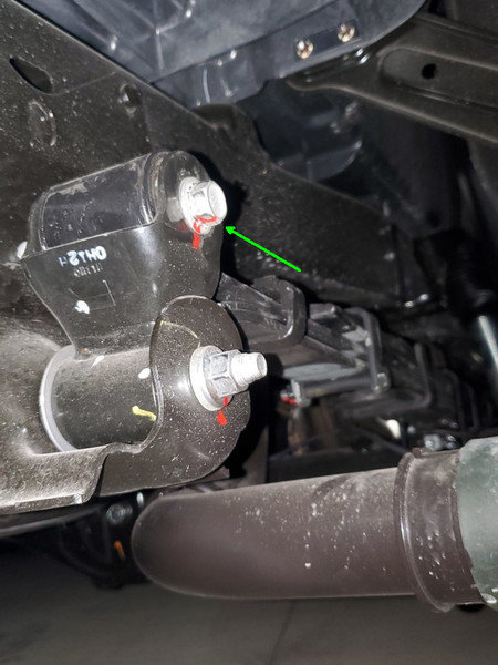

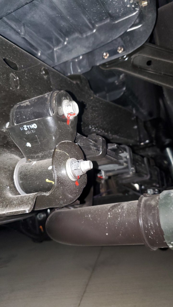

    In addition to the AAL being in the wrong place and wrong orientation, the top shackle bolt has been installed backwards. It may dig into the frame bracket when the suspenion flexes:
    Correct orientation: https://i23.photobucket.com/albums/b359/TokyoTitan/IMG_1439.jpg
    The bolt on your driver's side is pointed outward in the correct direction.

    I would also question the main leaf pack if the AAL was installed flipped wrong- seems like tightening down the U bolts would force all of the leafs against their arch.

    One way they can make it worse is pointing the AAL's rebound clip bolt inward, so it digs into the fuel tank strap...
