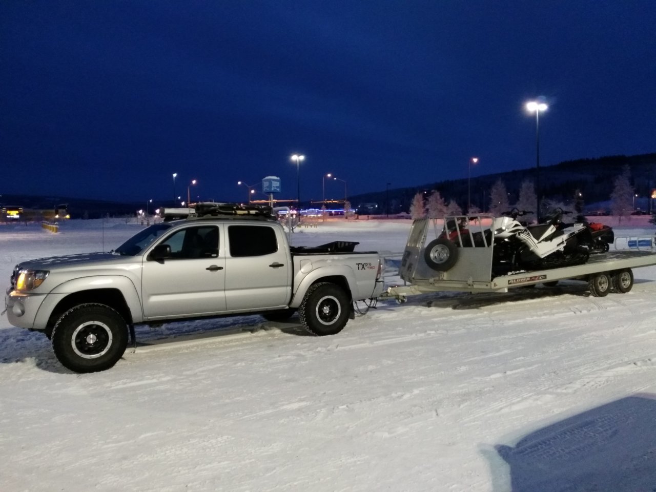

    This was a couple years ago, 3000# with a new TSB leaf pack, 3 leaf AAL and the overload. You can see the rear squats. The trailer is loaded a little front heavy and there was probably 150lbs in the bed. The stock suspension, even with AALs, sucks.
    woods327[QUOTED][OP] likes this.

    Wow sweet rig. Thanks for posting this it gives me a good idea. So that trailer load is about 3000lbs?
