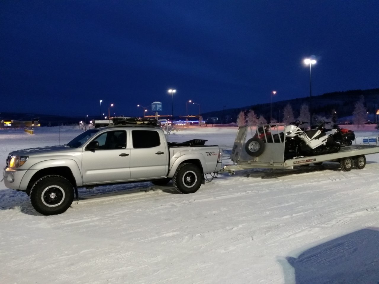

    I'm curious as to how much those machines weigh. There are two in front of the axels and one behind?

    White one is about 575lbs wet, the other two are about 525lbs wet. Two in front, one in the back.

    Wow that a lot of tongue weight isn't it? I don't tow just curious.

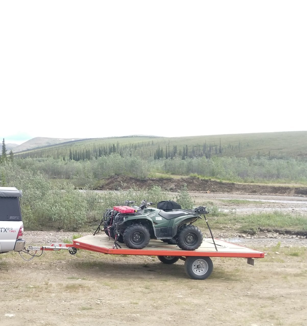

    I’m not sure how the numbers would work out. The axles are about centered on the deck so the back of the front two sleds are over the first axle and the second sled is over the rear axle and overhang. There were no problems with the weight distribution having adverse effects on the truck.
    The trailer I normally tow is a steel framed single axle 8.5’x12’ vee nose with two or three ATVs or two sleds on it. That’s also loaded with the weight just above and forward of the axle and tows without problems. Moving the two ATVs further back causes the tongue weight to be too low and start to sway a bit at speed.

    I see. Thanks for the great answer. Swaying is not good and I hear the voice of experience here.

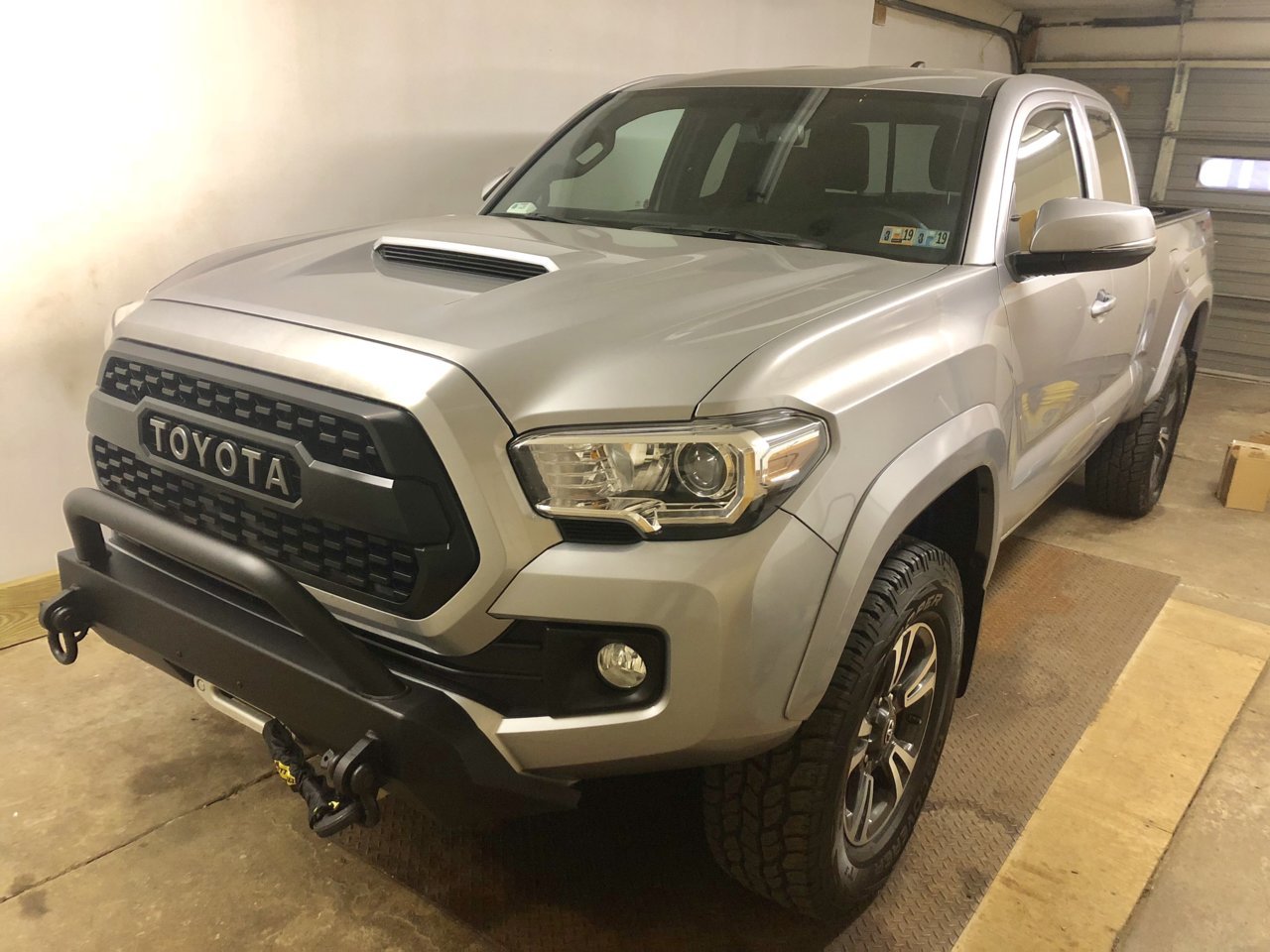

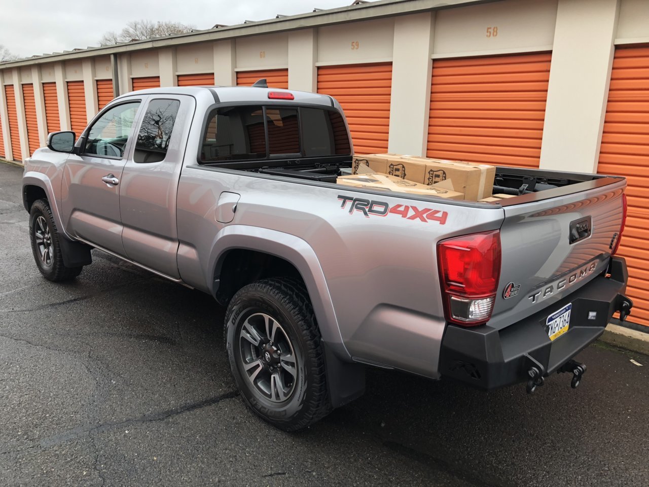

    I’ve got Bilstein 5100s all around and AAL with overload in, stock springs.
    Net gain 1” in front (150+ lbs slim bumper +winch) and 1.5” in rear (300lbs plate bumper + crap in bed).
    Stock is 1” higher in rear so now I’m 1.5” more in rear, but goes to near level (maybe .5”-1”) when hauling or towing.
    It’s a stiff ride but that’s what I want since I’m mostly on the street and it looks stock.
