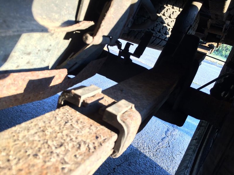

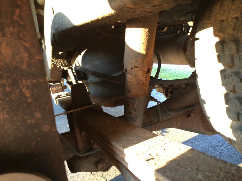

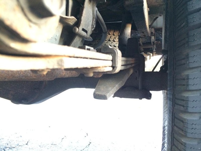

    is it possible to aal to these leaf springs? i was going to get new springs but they aren't cheap and if i can ill just keep it like this and add a leaf with the bilstein kit on toytec

    Other than being dirty and rusty. They look fine. I think you would probably be fine with just an aal.

    they seem straight as an arrow which i assumed to be not so good.. they just don't seem to be in very nice shape to try and lift em up a bit

    Straight is good!! Frowning is bad.
    But I will gladly set you up with a pair of Replacement Leaf Packs if you would rather go that way.
