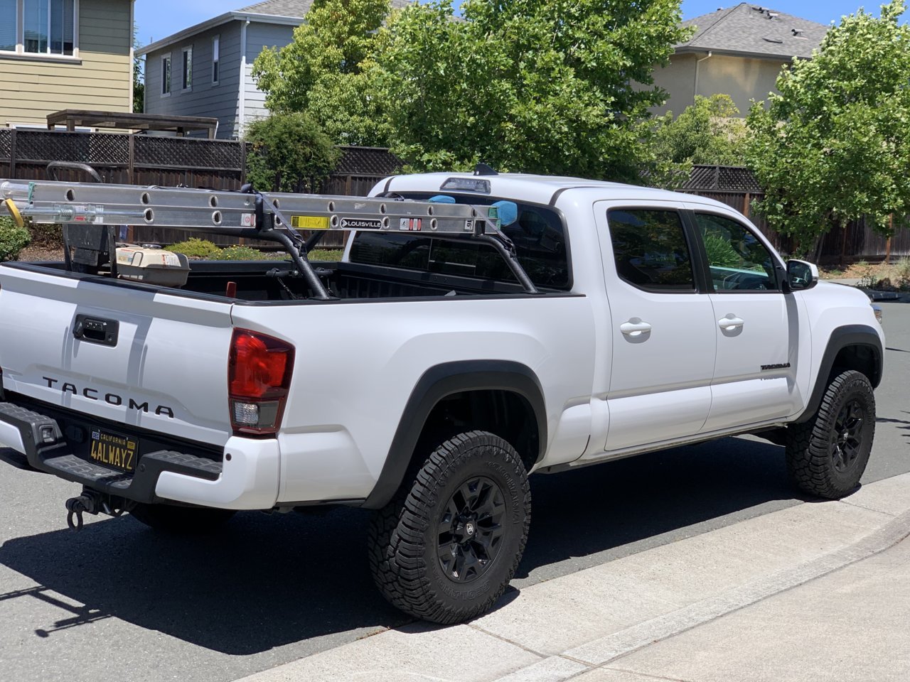

    wheelers 1.5” aal.Overload in. Imo not stiff. That’s in the eye of the beholder. More payload etc. It’s a truck used like one. Also you can use factory ubolts always a plus
