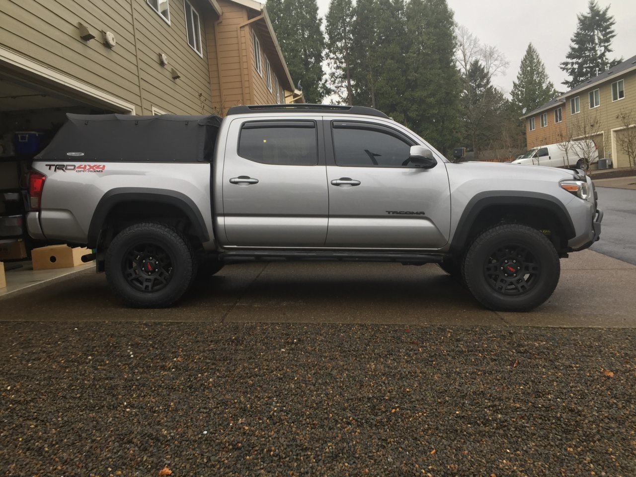

    Your operating angles should be close. The CB drop is the quick fix, the right fix is ditching that and going with shims. I have 2” of lift and run 3-degree shims with the Dakar medium pack and my operating angles are 0.2 degrees off from each other. It’s best not to lower the front shaft. I’ve been through this mess ALOT with my Tacomas. If you aren’t lifting more than 3” and no less than 1.75” you should be good with 2-3* shims
    This is what my truck looks like with what I described and it rides cherry.
