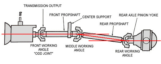

    Isn't the cb drop a little more than a quick fix though? I thought the propellor shafts need to be in line with each other, so won't that be possible with the CB drop? But yes you're absolutely right, the 3* shims sound like a must for most goijgntk dakars.

    Is not about the shafts being linear it’s operating angles.

    I think we have the same train of thought. Your example shows the output shaft working angle being in line with the first prop shaft and the angle located at the carrier bearing being within/identical with the pinion angle. I think you can have the output shaft be at an angle as long as that angle matches the pinion angle and the two prop shafts are in line with each other. Right?

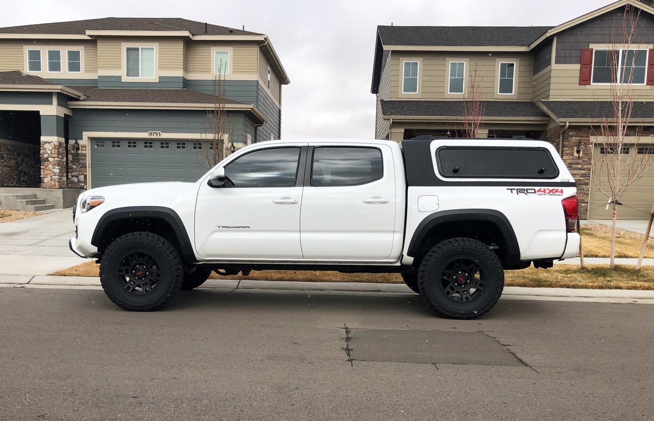

    I recommend doing the full Dakar leaf pack. My lift in the rear is a little under 2 inches with the topper. It handles the RTT and gear much better with the Dakar Medium Leaf pack. I sometimes think I should have done the HD Dakars but don't ride around with the RTT on the truck all the time.

    Nice looking rig. That canopy is slick

    Like I said, it’s mainly a last resort to use the CB drop if shims don’t cut it (this is rare)

    As far as getting driveline angles right. Id recommend installing the pack without shims and no CB drop. Take it for a drive, if you feel vibes, drive to the hardware store and grab some fender washers and some longer metric bolts the same size as the stock CB bolts (dont remember the size off the top of my head, probably m10 standard thread pitch, maybe m12). Dont spend your money on a CB drop kit, you can get better results with stacking washers. Start around 1/2in of a stack of washers to lower the CB. Take it up to 3/4in if vibes are still present. See how things get better or worse.
    Then move on to shimming the rear axle.
    Best thing to do is measure angles and go from there. FYI im running ~ 1/2-5/8ths of an inch of CB drop, and 2* shims on the leaf but with the fat end facing FORWARD, to tilt the pinion down increasing pinion angle. This is the best combination of mitigating vibes on MY TRUCK.... each truck is unfortunately different.

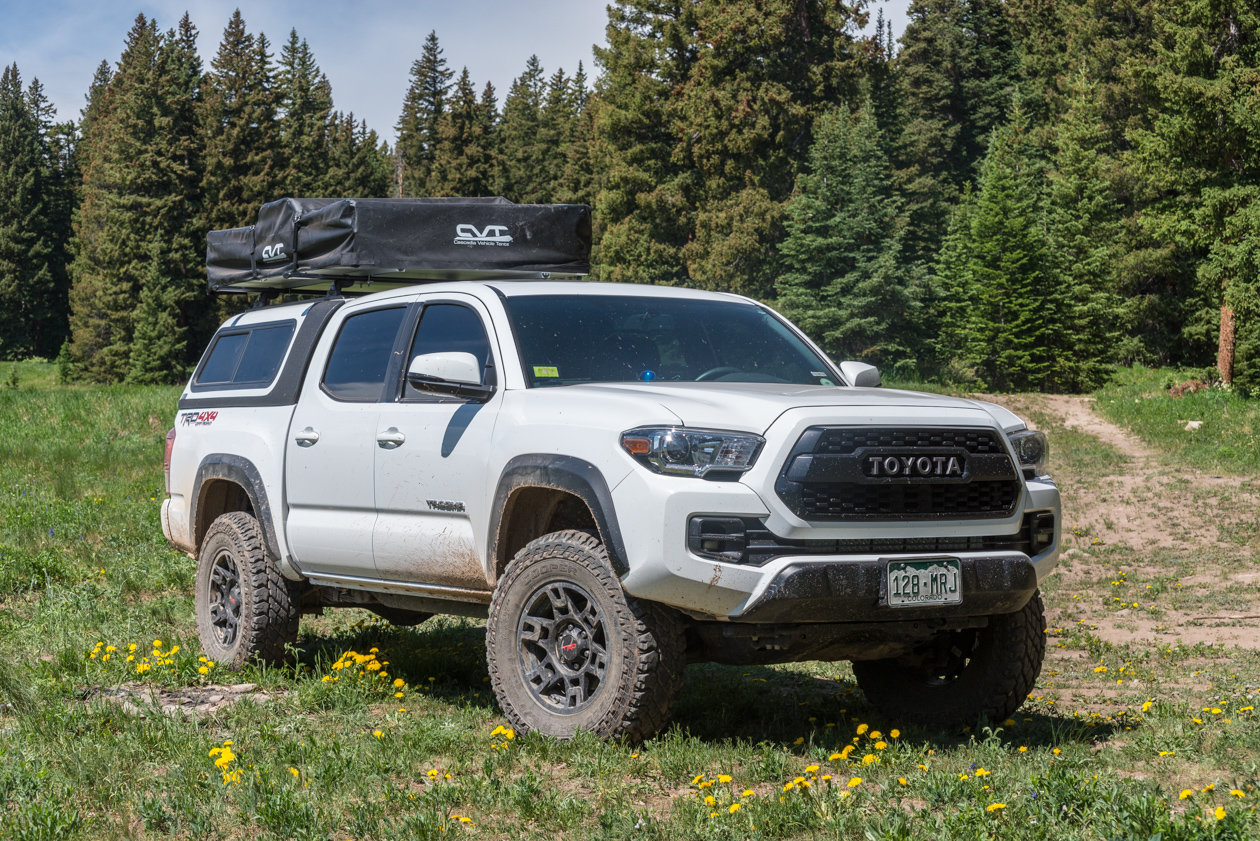

    The photo without the RTT, Truck has the 30-40 lb Tacoma bed mat, 2 maxtrax, a bin of tools/emergency kit/shovel and axe. If I had no topper and an empty bed, I would probably get over 2 inches empty. Even with the RTT and lots of camping gear it sits pretty level and feels way better than when I had the RTT on the stock leafs. I think that top picture, truck has all the camping gear loaded up. RTT weighs around 165 lbs if I remember correctly. I was told the Shell is around 150-175 lbs.
