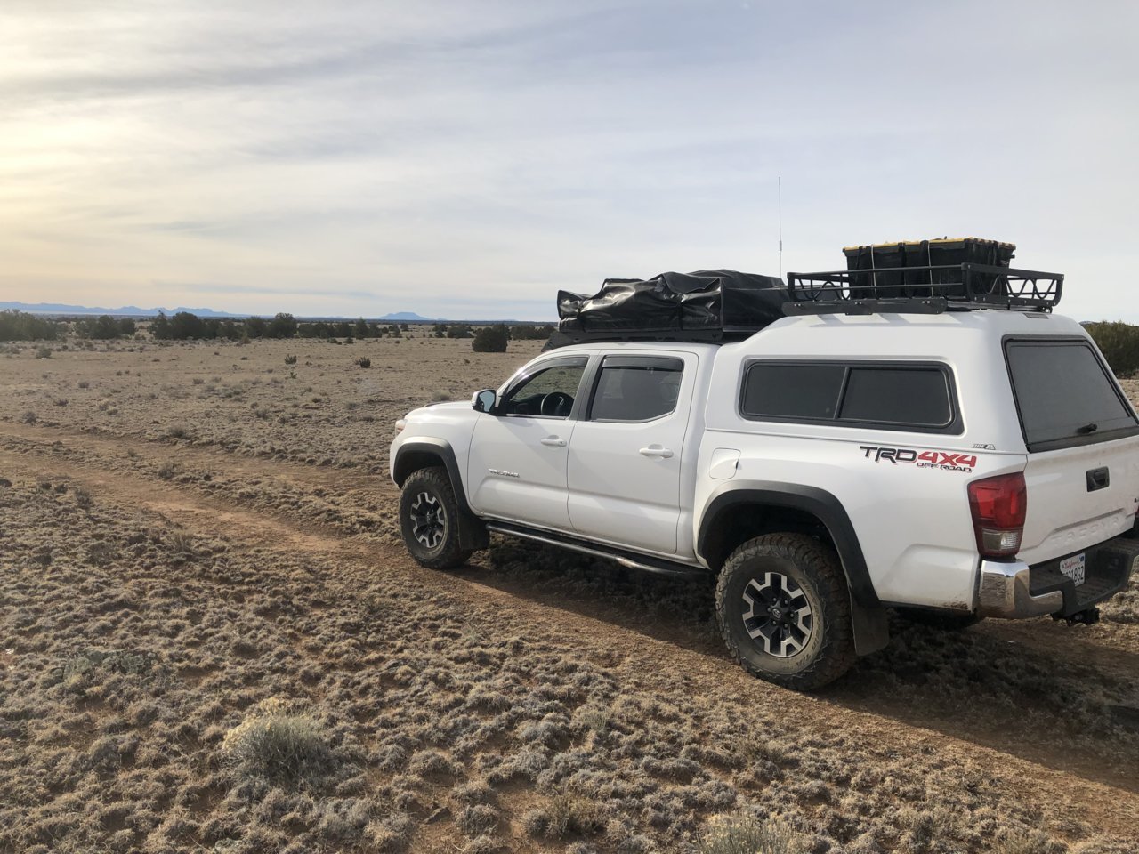

    Deaver AAL plus Firestone shocks with Daystar cradles. Offroad adjustability for gear and RTT loads, towing and flex:

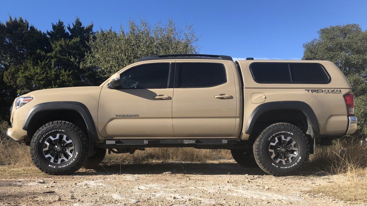

    Snugtop Rebel with some options Body Armor Rock Steps Rhino Mats Weathertech Mudflaps Radar detector hardwired to rear view mirror. Stereo upgrade: Amp: Arc Audio XDI805 LOC: AudioConnect LC7i Front Speakers: Hybrid Audio Technologies Claris 6.5 Rear Speakers: Hybrid Audio Technologies Mirus 5.25 Sub: Pioneer TS-SW2502S4 Box: Pioneer Ud-SW250T Bilstein 5100s OME 885 Springs Single Add-A-Leaf BFG KO2 265/75/16
    885s in the front with a single AAL in the rear. Running a camper shell and have 1.5" of rake with bed unloaded and even with over 200 pounds it's still not nose high. I didn't have to adjust any angles. Everything is within spec and no vibrations or noises.
