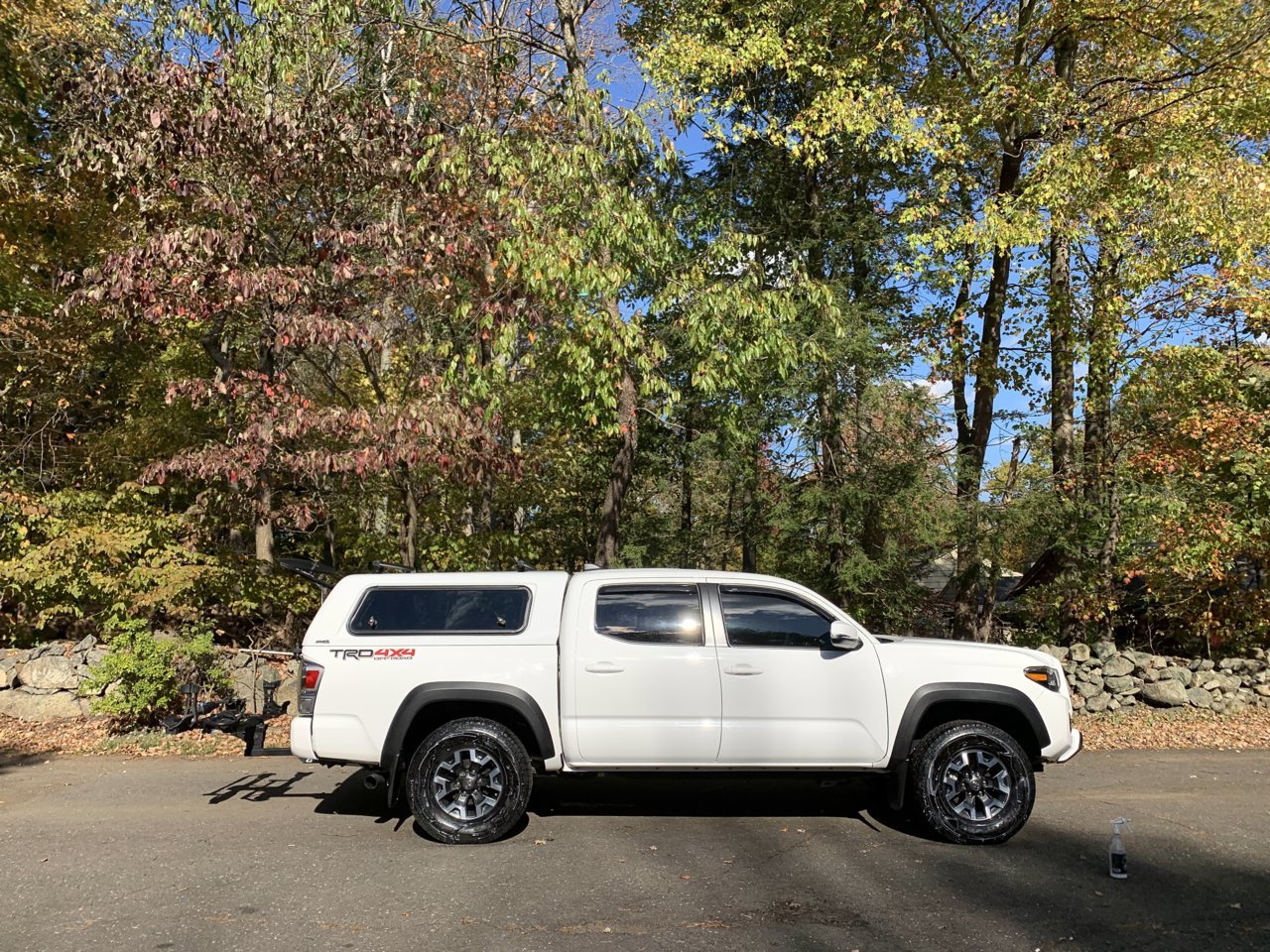

    I have about 350lbs in the bed with a camper shell and drawers which is making my rear sag a good amount as expected. I have a set of assembled Bilstein 6112/5160’s and dakar HD leafs on order for a 2.5/2” lift and 285’s but I’ve come to think about how happy I am with the stock suspension and the idea of not messing with the truck at this time. Also liking the idea of a nice set of 265’s for the time being.
    If I just wanted to bring the rear back up to stock height, should I do AAL’s or something like the regular dakar leaf packs?

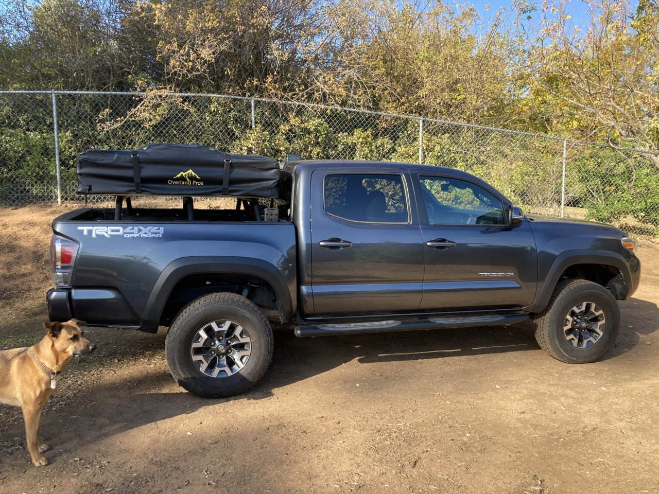

  8. Dec 11, 2020 at 9:38 AM
    Yroundrdn
    Yroundrdn Active Member
    Jun 27, 2020
    #332678
    38
    Ben
    San Diego
    2020 TRD Off-Road
    This is my truck with just the one add a leaf and a slight lift in the front due to the winch and bumper.69CDD157-CAAA-4804-9CB4-634ADB0CC121.jpg
