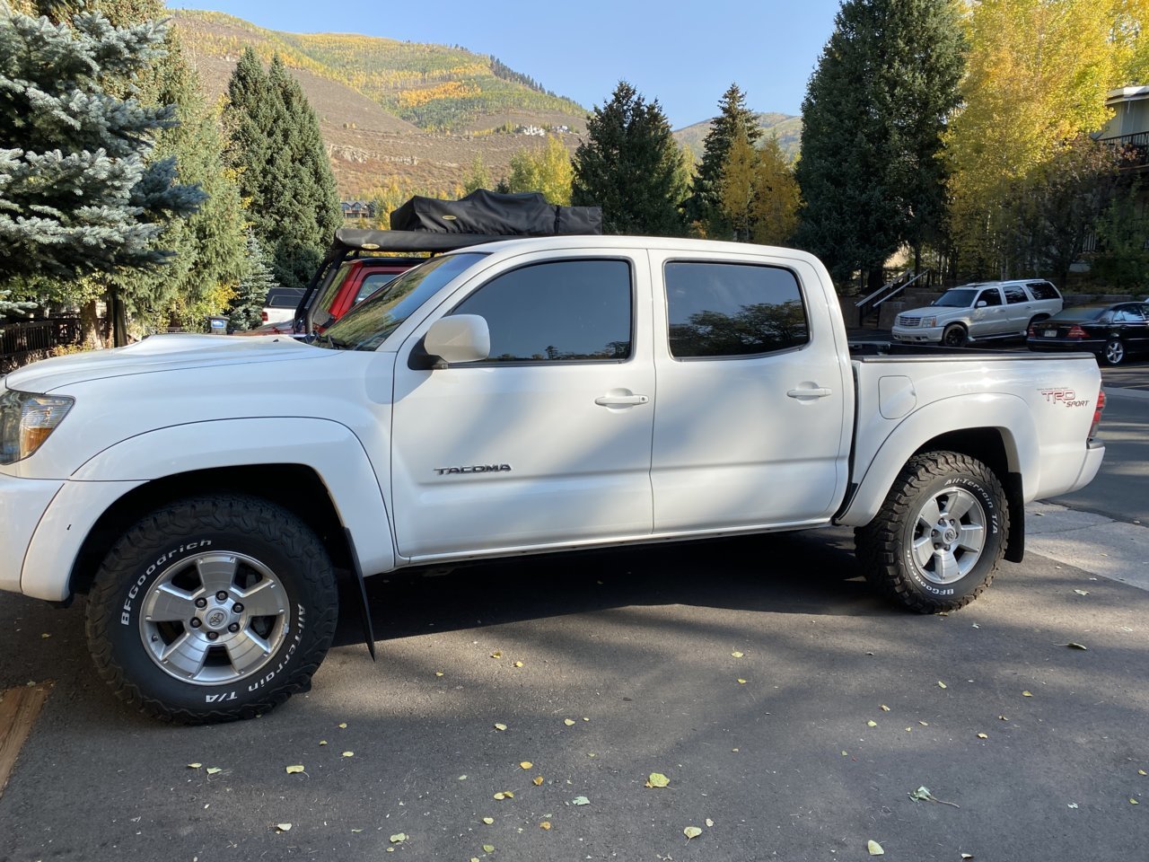

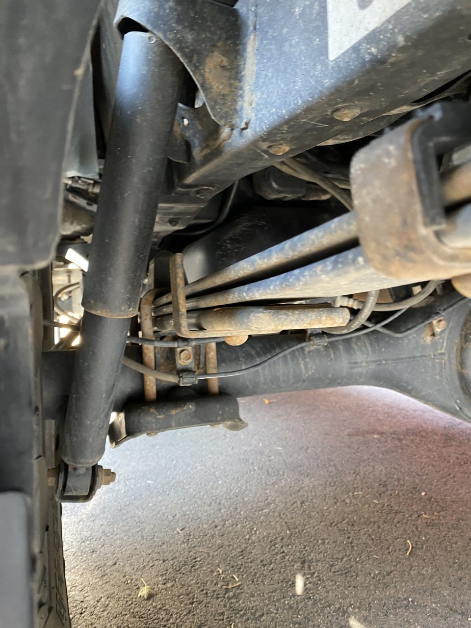

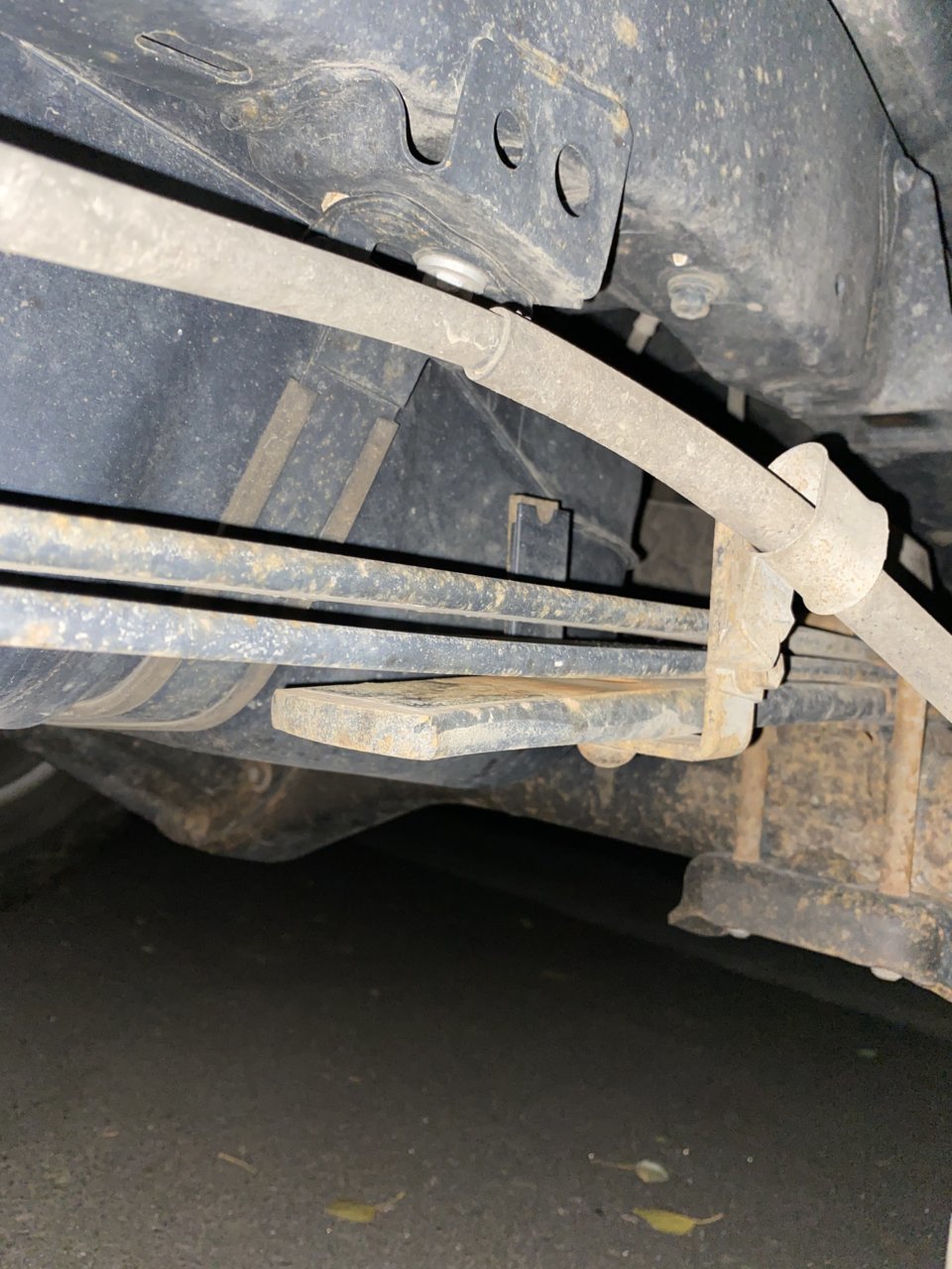

    I have recently realized that my rear leafs on my 2011 DCSB TrdSport are pretty much shot... It looks like the previous owner never did the TSB upgrade so I am stuck with sagging 2 leaf+rebound. The back end of the truck looks low and I need more carrying capacity for a topper. SO the question is, do I do a 3 leaf progressive AAL like the Toytec Mini 3 leaf, which seems cheap, but can you do an AAL when you current leafs are already sagging like this? Will it make it better? Or should I drop the $550 on the OME EL111r Spring pack? IMG_1078.jpg IMG_1095.jpg

    They are all the same I believe all the way up to the new 2021 Tacoma. OEM Leaf Pack, I don't believe a single AAL will help you much.
