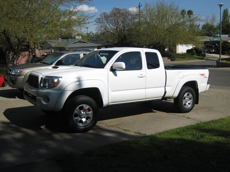

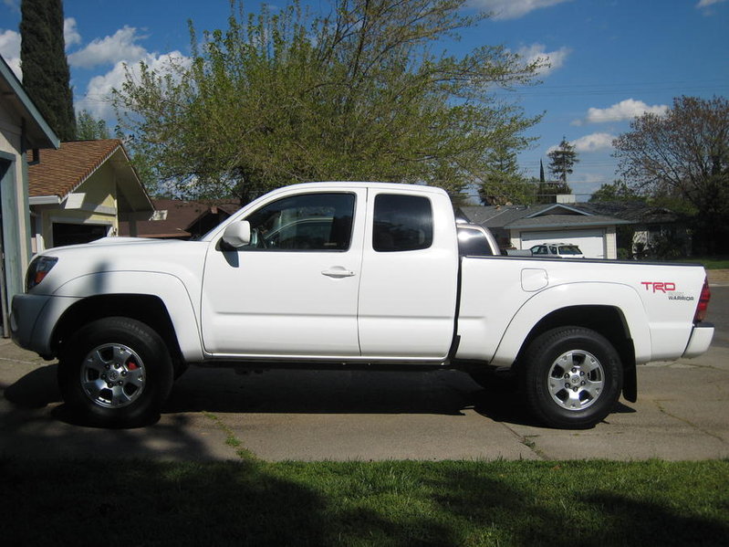

    I just put 5100s in the front at 1.75 with stock rear (no tsb) and am still higher in the back by 1/2 inch but looks very level (when its not parked on my slanted driveway):D
