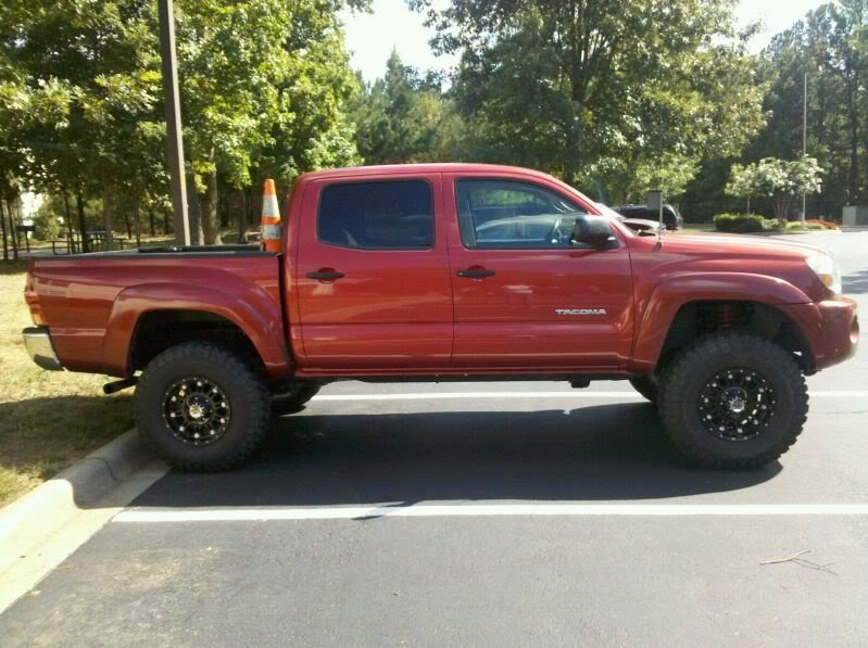

    I'd guess the long side toward the rear is to help prevent axle wrap. Just a guess, I'm not really sure why they're set up that way. Nice truck!
