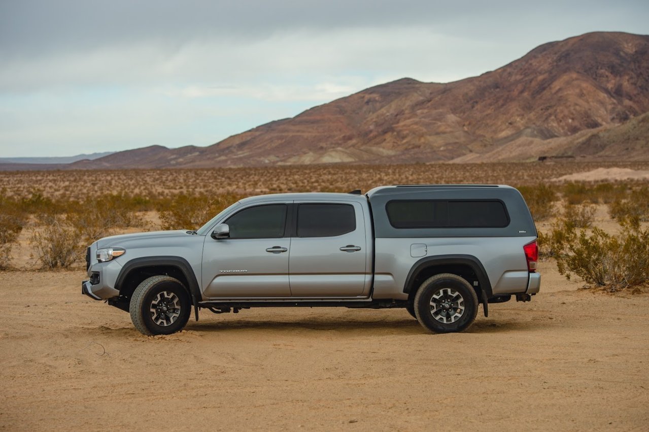

    AAL vs Hellwig Helper Spring (980 ez-level) vs SummoSpring (SSR-610-40)
    For a Long bed with permanently mounted cap and sleeping platform/storage drawers.
    What are your thoughts?
    I'm looking for a cost-effective and noob friendly install.
    Leaning towards Sumos atm. In a few years, I may put Dakars in.
    Not looking to lift the truck.
    Did you modify your suspension after installing a cap?
