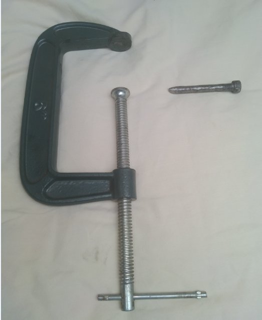

    Note that I was working alone with a bad shoulder that sometimes limits my range of motion. So I often develop crutches (guide pins) to help in places where I often don't have a 2nd set of hands. I'm not sure why, and it may have come from reading other member posts about AAL installation on a 1st gen, but I removed the springs (one side at a time) to install the AAL. Looking back, I think it may have been easier to work with the springs off the truck than on it.
    In the image below, I have a picture of what I did to work around missing video frames. After purchasing the AAL + Shim kit, I found I had four spring bolts (two extra). I took one of the bolts and ground off the tip to make a guide pin for aligning the springs before I installed the alignment bolt. That let me make a guide pin that was the exact size of of bolt that I needed to insert. I had tried to align the springs with a Phillips screwdriver. The problem I had with that was the screwdriver size was either too large to go into the hole or too small to give a good alignment. If the springs are not in perfect alignment over the bolt hole, the threads may become damaged from scraping against a misaligned spring.
    https://youtu.be/Eq9nv_3vU4Y
    Here's a picture of the C clamp that I used and the guide pin that I made from one of the extra bolts. Any bolt from a hardware store or old bolt that is the same MM thickness as the spring bolt will work.
