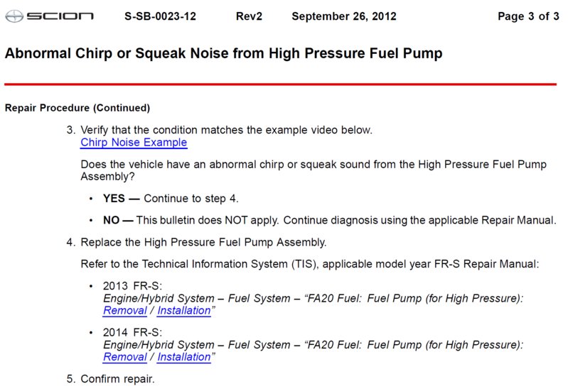

    '17 TRD Off Road DCSB
    Didn't read the whole thread, but it's completely normal on D4S/DI cars. Most notably, FRS/BRZ has had a TSB out for it and will replace it, but it will most likely come back. Use less ethanol or ethanol-less gas in your car to minimize chirps. It's normal, not detrimental to the car, nothing is "broken", albeit a bit annoying at times. Toyota hasn't released a TSB on the Tacomas for this, but even if you get them to replace it, it will most likely come back.
