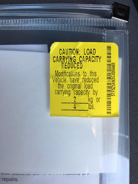

  6. Feb 24, 2017 at 9:53 PM
    #326
    Dick Danger
    Dick Danger Member
    Nov 10, 2015
    #169236
    16
    Richard
    Pasadena, CA
    2016 TRD Sport 4x4 AC
    Z series shell BAMF sliders
    Also, I noticed this sticker on the door sill and peeled it off. Why does this replacement fuel pump assembly/installation reduce 4 pounds of carrying capacity?
    For those who had their fuel pump replaced,, do you have this too?

  7. Feb 25, 2017 at 6:12 AM
    #327
    Mag16tac
    Mag16tac Well-Known Member
    Apr 18, 2010
    #35534
    130
    2018 Ford F150 XLT 2.7 ecoboost!!!!
    The sticker is an update, I don't know why they did it during a fuel pump replacement but my dealer placed that sticker in my door after a TSB for the transmission was applied.

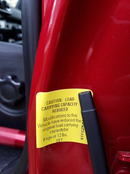

  8. Mar 14, 2017 at 2:07 PM
    #328
    remgu2000
    remgu2000 Keepin' on keepin' on.
    Aug 29, 2016
    #195912
    1,568
    Ray
    Roswell, GA
    Used to have a 2017 Barcelona Red TRD Off-Road DCSB 4x4
    I just noticed mine... WTF...12 lbs! :facepalm:
    I assume it's been there since I bought it since I haven't had the dealership add anything.
