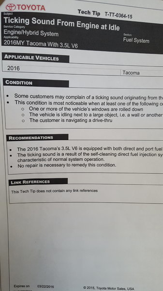

    So, here's the good & the bad from my truck today. Couldn't pick it up until the service managers were gone. No major issue - stupid lady who checked me in put the damn thing in 4 wheel drive! smh!:boom:20160622_181520.jpg
    It appears they checked the trans fluid properly, but I'll probably look into checking it myself anyway just to be sure. As far as this thread title and the main reason I took the truck in, they did nothing and attributed it to "fuel injection tick", which it is not (I know the difference), and after a lot of research I am about 90% sure it's the high pressure fuel pump. They attached the following "tech tip" to my paperwork. I'll be bringing it back in, possibly to a different dealer (although that's 30 miles away) when I get a chance. Chirping just the same when I got it home.

    Right. Ticking is fine. Chirping like what I have is the High pressure fuel pump. When in doubt, take it to another dealer
