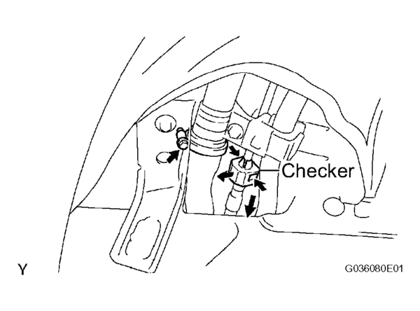

    Hi all,
    I'm gonna have to remove the bed on my 2010 Taco, I've been searching around and I see lots of posts about it being simple. Everybody says I only need to remove the 6 bolts, unplug the taillights and make sure the gas tank filling tube goes through when lifting the bed but I can't find what holds that tube in place ?
    How do I get to it and free it from the body before lifting the bed, is it bolted or just clipped in somehow ?

    This view is from the wheel well. Looks like you just remove the breather tube & unclamp the filler tube and should be good to go.
