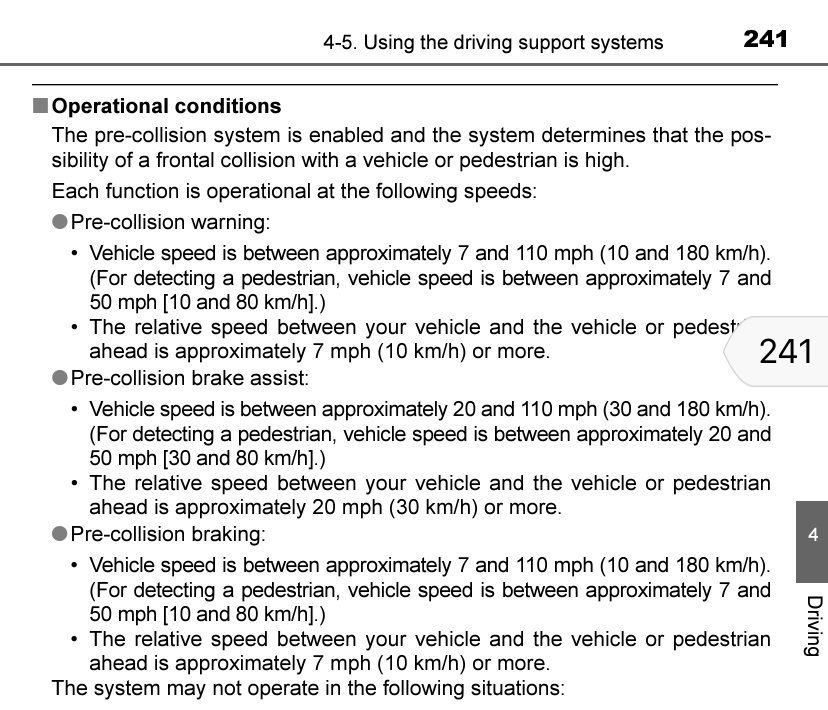

    Good to hear about the 7mph limit. I was going slow through the intersection so that's probably why I didn't get a TSS warning.
