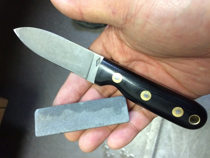

    I got it. All I needed was an aggressive enough stone to cut my initial bevel. THEN! Transition to a finer grit.
    I had to cut some ridiculous cardboard. Lots of it. My SAK was instant butter knife. One of the office bosses, digs into his pocket and pulls out this minuscule whetstone. It’s the one the winery field workers use to hone pruning tools. With skepticism, I got honing. It was fast cutting and in quick order, my knife was damn sharp. I have a fine portable diamond plate. Quick swipes then leather....... yeowza. Surgical. I took my most stubborn knife to work the next day to try again. Borrowed the same stone. Same results.
    I found a farm store and bought a few pocket stones. $1.99 each.
    I don’t think I need it all the time, but it’s there when I need it. I bet it will be great on an axe.

    Pic. My PIA to sharpen BATTLE HORSE KNIFE

    Except it isn’t compatible with all blade grinds.
  16. Nov 8, 2017 at 8:43 AM
    #16
    T4RFTMFW
    T4RFTMFW Well-Known Member
    Jul 23, 2014
    #134525
    69,801
    What blade grind is that? Looks like a full height flat grind? Can’t figure that’s what it is though.
    Beautiful knife. I have a BHK Woodcrafter in Scandi grind with green micarta scales. They’re excellent.

    is it the angle or what?

    The WorkSharp has different angle guides for the different blade styles. Pop one guide off and pop the other guide on.

    Everything gets a convex blade with a work sharp, due to design. Changing the angle guide just changes the angle, it doesn’t prevent convexing an edge that isn’t meant or wanted to be so.
    They’re great for convex knives, but that’s about it. Also if you’re not interested in learning how to sharpen and have money to burn!
