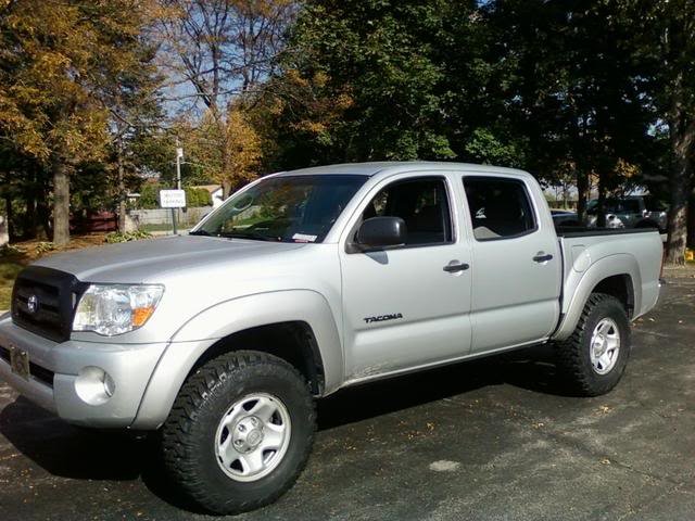

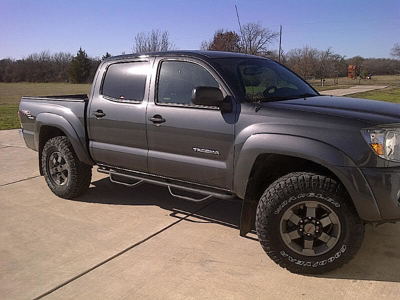

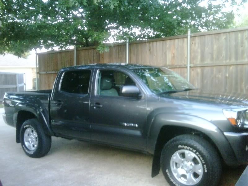

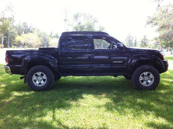

    Hey guys, just wanted to throw it out there that I'm planning to buy 2 front 5100s from DSM clicked up to 1.5". I'm hoping by doing that, I can achieve that level look with a stock rear. I have NOT done TSB either. I'm also going to replace the stock 265/70/16s with 265/75/16s to give about another .5" so in theory my ultimate goal is to get about 2" of lift from the stock height. I don't wheel, but I do have to use 4x4 in the mud every now and then. I don't really want to go much higher than 2" so I"m thinking i can just leave the rear alone and not order anything for it. Whatcha think? I can't wait to give it a whirl! I'm planing to get the GOODYEAR WRANGLER TDs btw. Thomas PICS ARE HERE....ended up with the DURATRACS in 265/75/16 with front setting at .85" I'll try to take more if I can ever get home from work when it's light out :(
    BEFORE
    AFTER

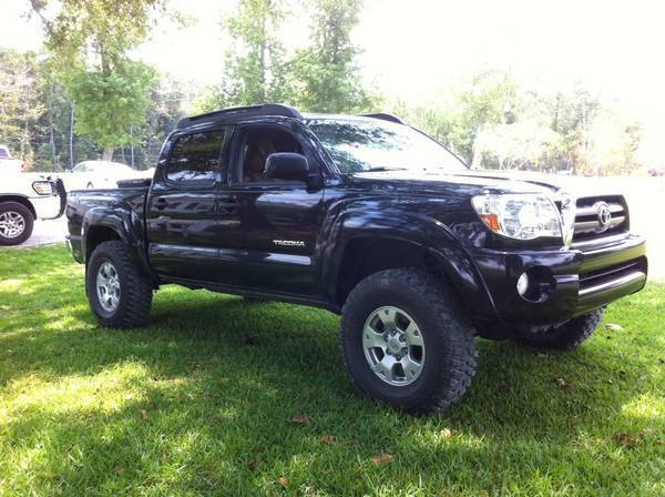

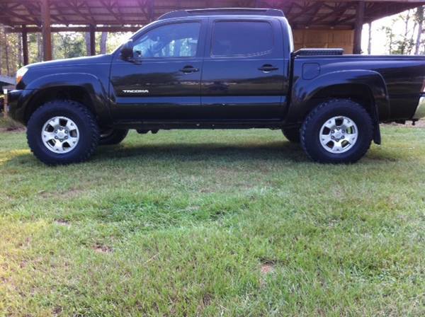

    Here is mine, front at 2.5 and 1" rear block. The truck is on a slight incline, but you get the idea. IMO get a 2" AAL in the rear because it will settle.
