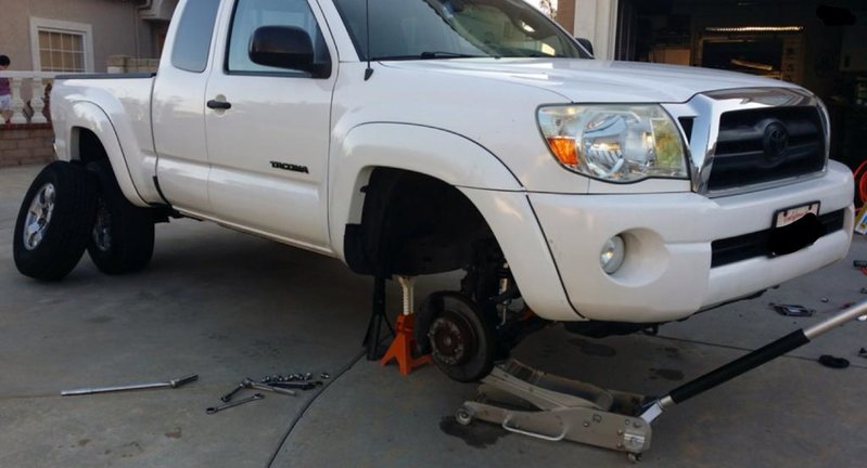

    A couple of updates.
    In my opinion, using the floor jack under the lower control arm is much easier than the cheap rental spring compressors. Probably safer as well. Just make sure the jack is under the lower control arm and not the lower ball joint.

    Installed my 5100s and 885s earlier, such a big difference from stock.
    Took me and a buddy a little over 3 hours to get everything all put together, using the floor jack under the lower arm method.
    Yeah I bought the new bushing and isolators from wheelers cuz the old ones were, well, old haha.
