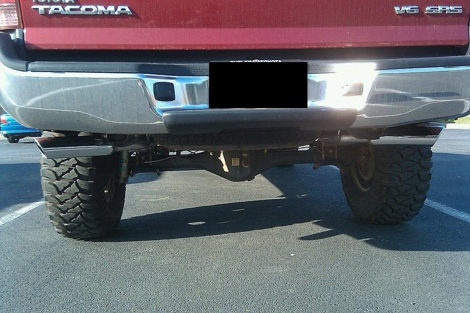

    Got it done today

    Sound clip, or GTFO. ;)
