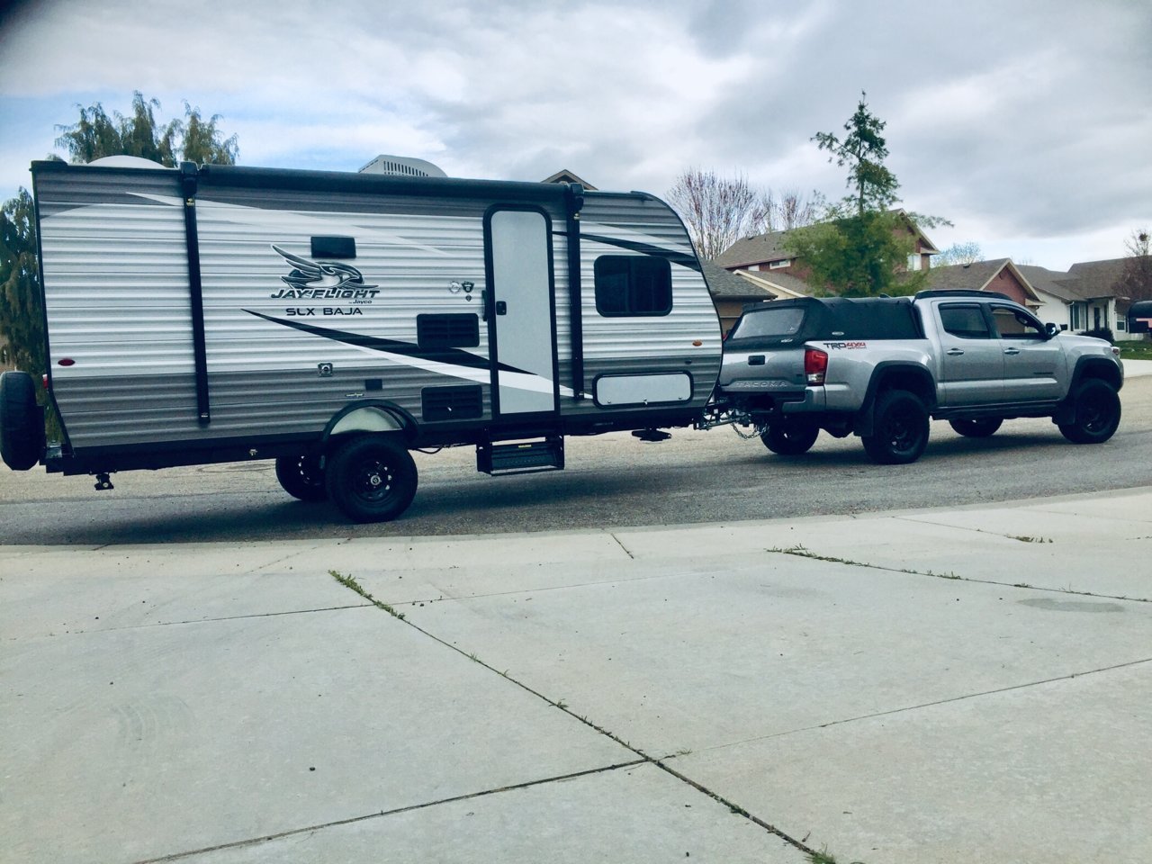

    What “switch” did you hit with your knee that caused a brake failure?
    Beyond that the Tacoma is marginal for towing a 5000+ load, no matter how many parts you throw at it. Time for a bigger truck or a smaller trailer.

    Brakes were probably smoking from all the assembly lubes and stuff burning off. Still, get a bigger truck and be done.

    That's too much weight but you should be able to feel your trailers brakes working try sliding the controler control manually then adjust the controller to apply more breaking it razes the voltage to the trailer brakes. You can try pulling the brake away cable it should lock the trailer brakes DO Not leave the pin out for more than 20 sec or so you run a risk of cooking something.

    Sounds like a lot of user error here between buying the wrong truck and putting your brake controller in a dumb spot. Not trying to pick a fight but you can't blame the truck when you're pushing it at it's limits. Also if your trailer brakes go out learn to downshift.
