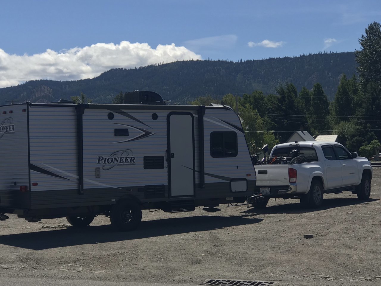

    I would guess that the loaded weight of that trailer is really close, if not over, the tow rate of your truck. Then add in people and gear in the truck, and you'll be much happier with a Tundra for that use.

    your trailer actually looks bigger than mine. I drove mine over the continental divide last summer too. I guess i am stress testing the taco lolDD6D45F0-F6BC-4308-9AEA-40E9EA87A282.jpg

    That's a little trailer. Here I'm thinking this thread's about a 24' tandem...
    I tow this all the time:
    My truck's over 6k lbs with all the armor and crap in it. We've been on dozens of trips for thousands of miles. No smoking. No trouble braking. No trouble accelerating. I can definitely feel it's there - it's 5000lbs of trailer that's wider and taller than the truck, so I leave more room and make liberal use of the skinny pedal. I get 10-12mpg. Still, temps stay normal and the truck does everything I need it to.
    If your brakes were actually smoking and you weren't being hyperbolic, you should check your pads, rotors, and brake fluid. That's REALLY bad and there's either a serious issue with your setup or you have a serious technique problem. The setup may be your brake controller - someone earlier posted a video. Saying your knee turned it off is your own incompetence, don't blame the equipment for that.
    Bigger trucks make it easier to drive recklessly with a trailer, but still, you need to be careful and take efforts to make sure your truck and trailer is set up right instead of just complaining that the Taco isn't enough for a little trailer like yours. I have full confidence I could tow your trailer coast to coast and back with not a single issue in a Taco.

    Yeah, the brake controller is in a bad spot I think. Its right near where my right knee is and if my wife drives my truck my seat is slightly to far forward,... I think I flipped it completely off accidentally. Once I fiddled with it the breaking seemed actually fine. But this one hill by my house is super steep but short and my because of traffic I had to essentially come to a complete stop. It was one of those wtf moments. I pull over and see smoke coming from the front wheels and I was like "oh shit"
