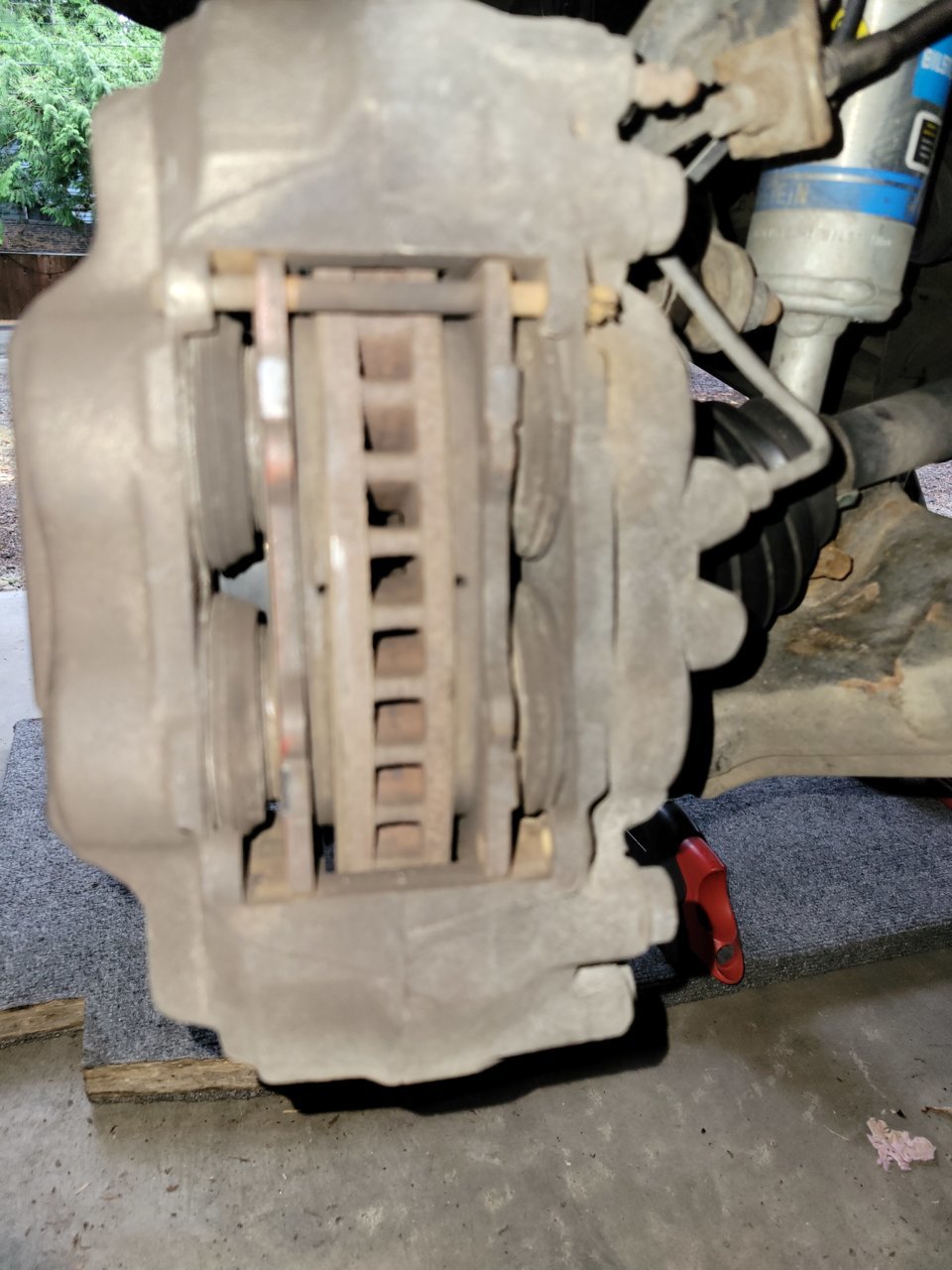

    It's my damn brake pads.....
    Looks like I'm missing the little springs or clips that keep the pads separated

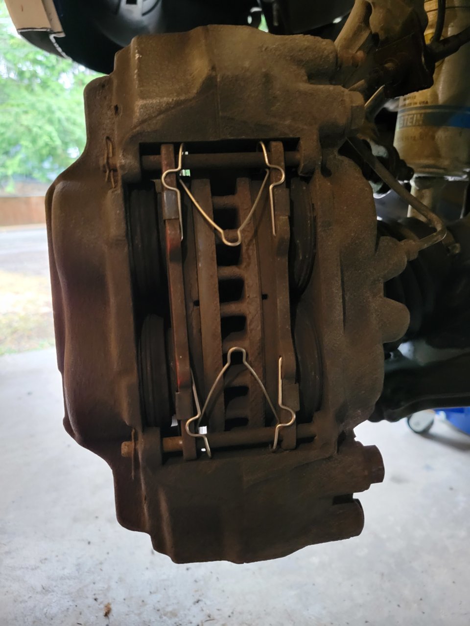

    3,000 plus on new front end parts, and a God damn 7 dollar part fixed it.....
    Doubled up the spring clip things on both sides. Good heavens
