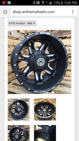

    Two reasons I was going with that set up. I want 18 and the pro comps All terrains. 18 come in that size 305. Also the wider tires will possibly help me avoid curbing my rims. My RBP's on my 250 are victims of my driving skills. Going with these rims

    What about back spacing of the rim. That would help wouldn't it?

    It would, how much you would need though, I'm not sure.
    As far as curbing your rims go, I would imagine you'd want more side wall to get the rims up and away from the curb?
