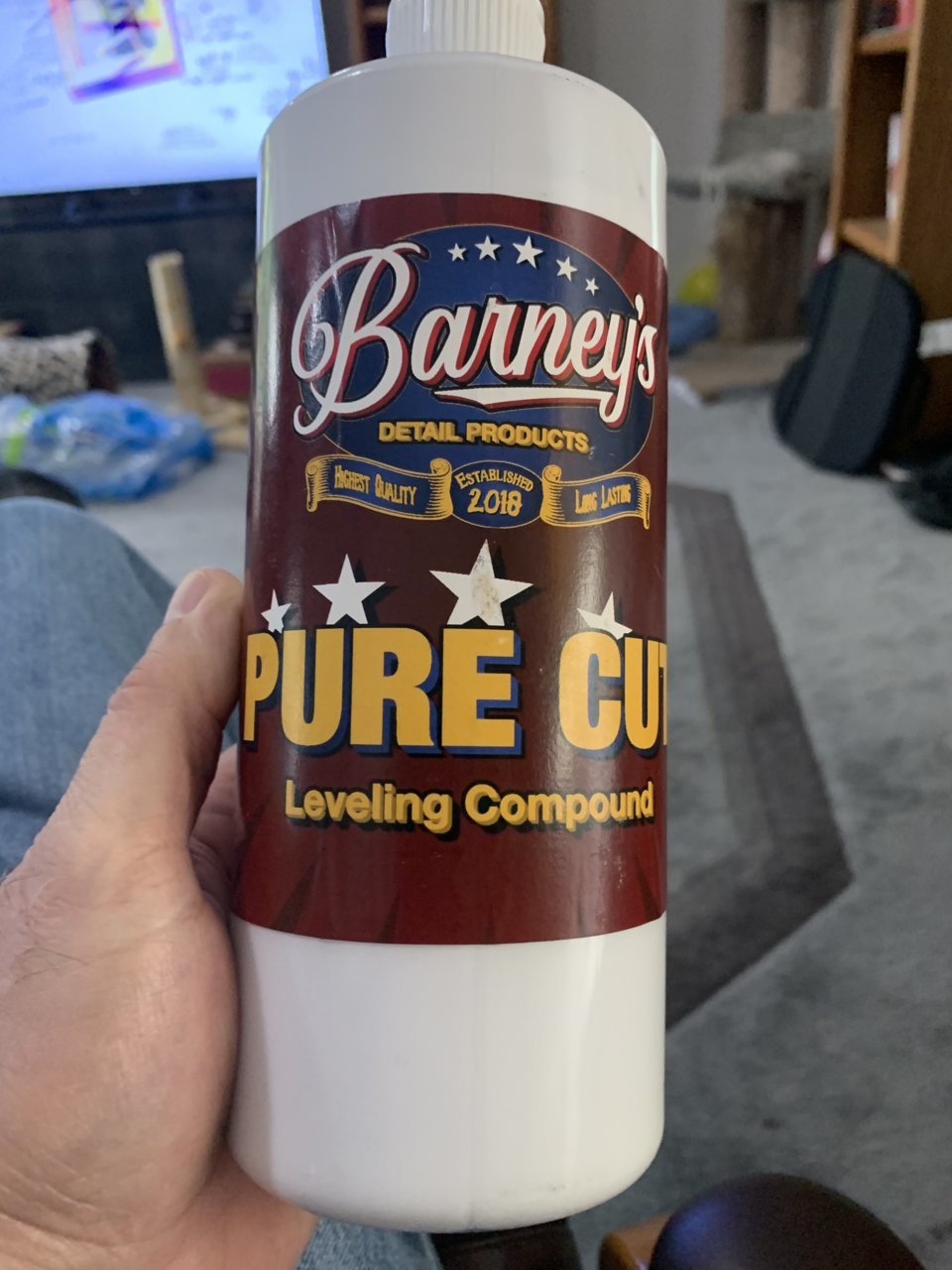

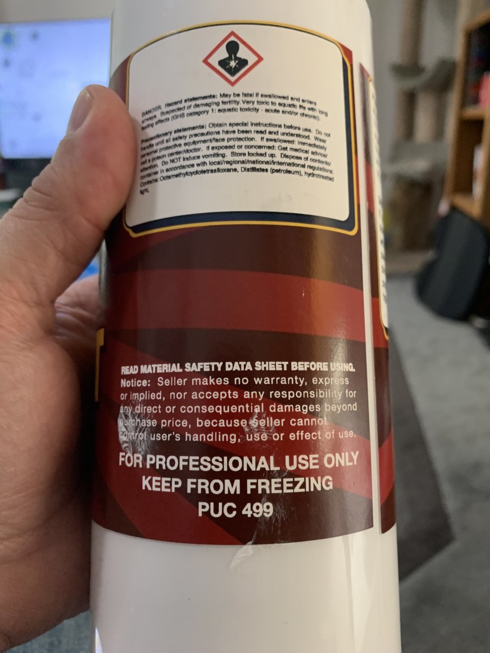

    1600 bucks, it’s just money. Here’s the skinny. The ceramic coating comes in different grades. The cheapest is a spray on wipe off such as “why wax” It lasts about 3 months depending on how you wash the truck. Retails at about 20-25 bucks.
    Next is a mid grade product it would last about a year Maybe longer again depends on how you wash the vehicle. Last time I checked it was about 100 dollars. The best products are around 200+ dollars and if applied correctly will last 3-5 years. You can coat the wheels and glass too.
    the real cost is in the labor and correct application, it’s easy to leave streaks if done wrong. It starts with a foam cannon soak and rinse followed by hand wash using two bucket method. Dry then paint correction using a product such as Barney’s leveling compound. Now the paint is clean clear is shining scratches are gone. Now you get a wipe down with 50/50 water alcohol and a final inspection.
    now it’s ready to apply ceramic you have to work in small areas per the instructions and not get in a hurry. It takes at least 24 hours to set up if you wanted to do another coating.
    the actual product cost is cheap you are paying all labor. It’s not difficult or mysterious work, many teenagers and women with no experience have done it. My wife and I attended a detailing class 40 hours at a vo tech college and it was well worth the money. Covered all aspects of detailing and featured factory reps bringing in professional tools and products.
    the takeaway? You buy your products from detail supply houses no autozone or Walmart. Professional grade no consumer level, ok? There are detail supply places in every larger metro area ask a detailer. You buy product in gallon or more but it comes out cheaper this way and you get real results not celebrity endorsed mainstream bull shite. There’s enough product in this container I’m holding to do between 10 -20 trucks. I also like talking face to face with the man making the products.
    While your at it tip the detailer well and form a working relationship and they may be likely to share info and tips with you. Industry standard detail uses less than 10 dollars in material per car that’s excluding ceramic of course. The rest is all labor. If you don’t mind paying labor then he’s your new best friend.

    It’s worth 1600 of don’t know how to do it. Or can’t do it or don’t have the tools. My Rupes buffer cost nearly 500 dollars and that Barney’s leveling compound is 40 dollars a bottle. So unless you have the necessary tools and skills you are pissin up a rope. Detailers with a following can make pretty good money
