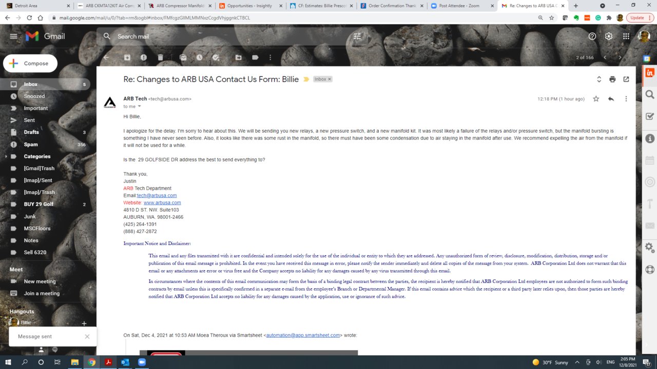

    This was a pleasant surprise... ARB is sending me a new manifold, 2 relays, and a pressure switch at no charge for equipment that is well outside of warranty. That's about $140 retail.
    Their response;
    Hi Billie,
    I apologize for the delay. I'm sorry to hear about this. We will be sending you new relays, a new pressure switch, and a new manifold kit. It was most likely a failure of the relays and/or pressure switch, but the manifold bursting is something I have never seen before. Also, it looks like there was some rust in the manifold, so there must have been some condensation due to air staying in the manifold after use. We recommend expelling the air from the manifold if it will not be used for a while.
    Kev250R, Pb12in, tacotoe and 2 others like this.
