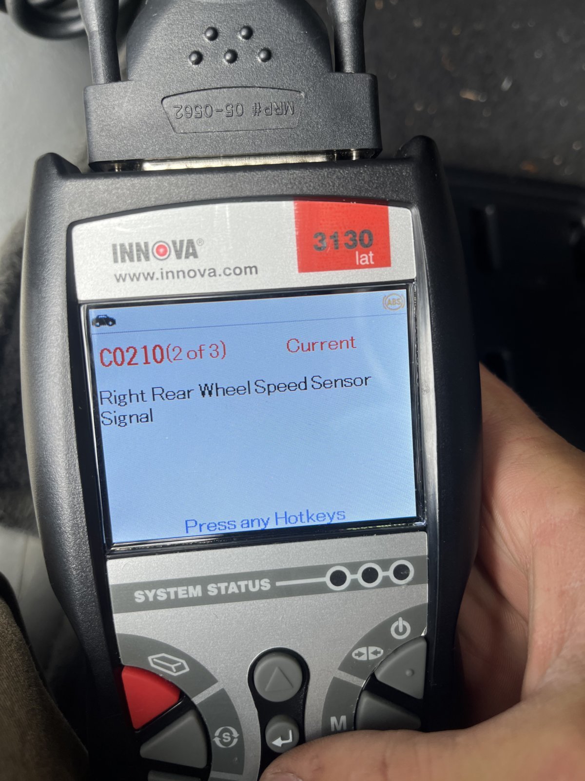

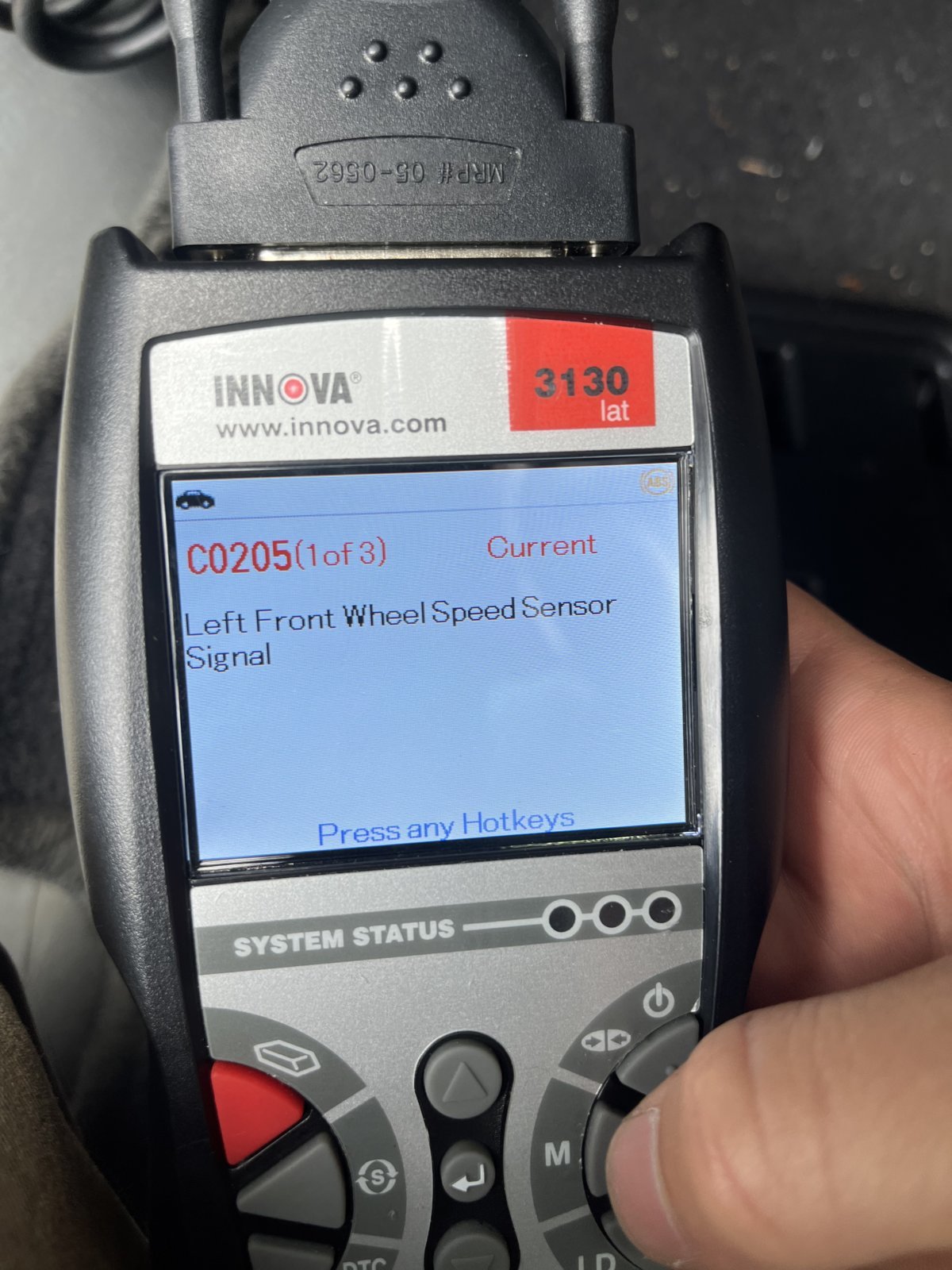

    So I’ll start by saying I have a ABS and brake light on. I went in got a ABS scanner and I can see that it is the drivers front and passenger is rear sensors that are off here’s a photo of the code.

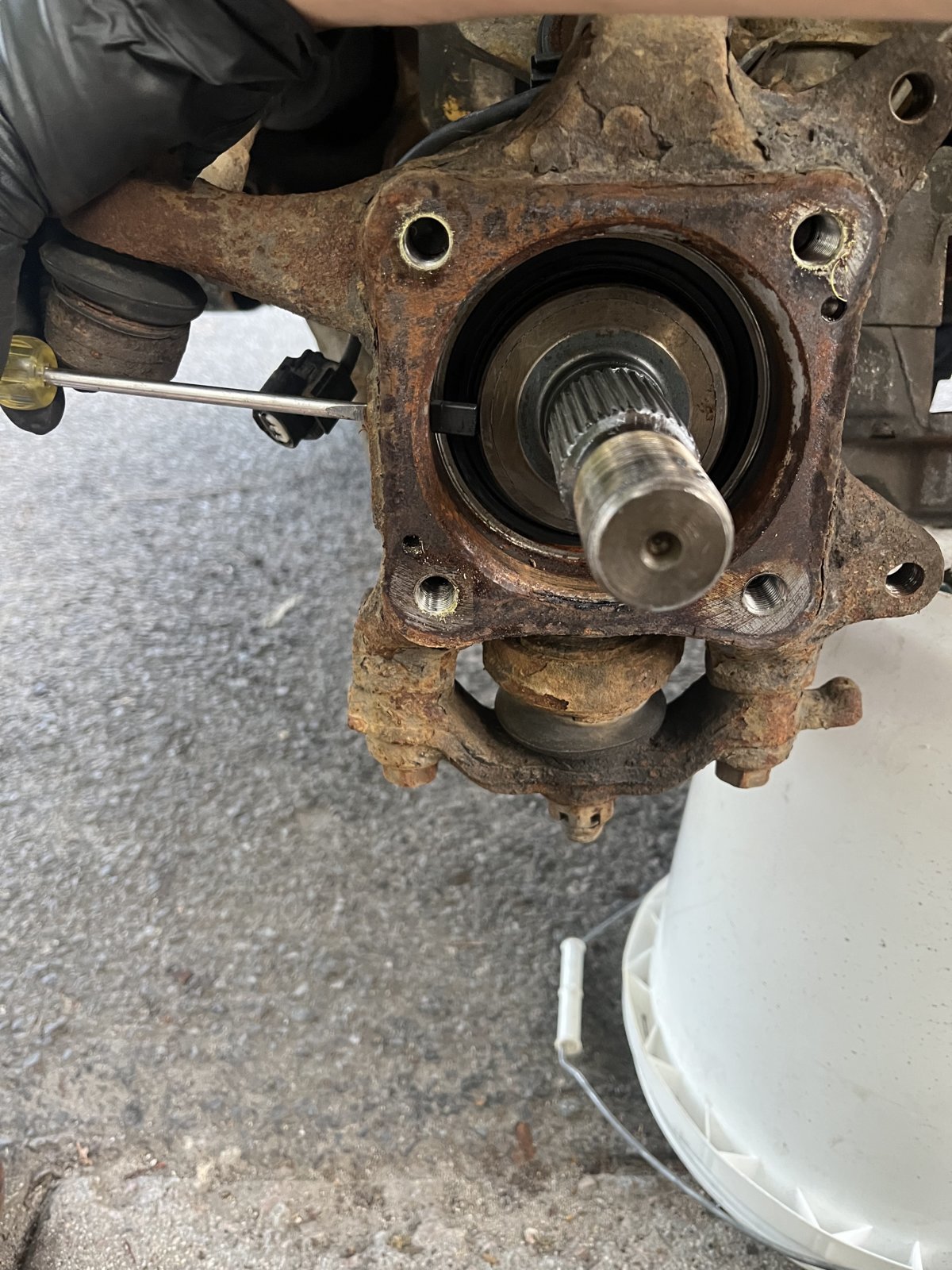

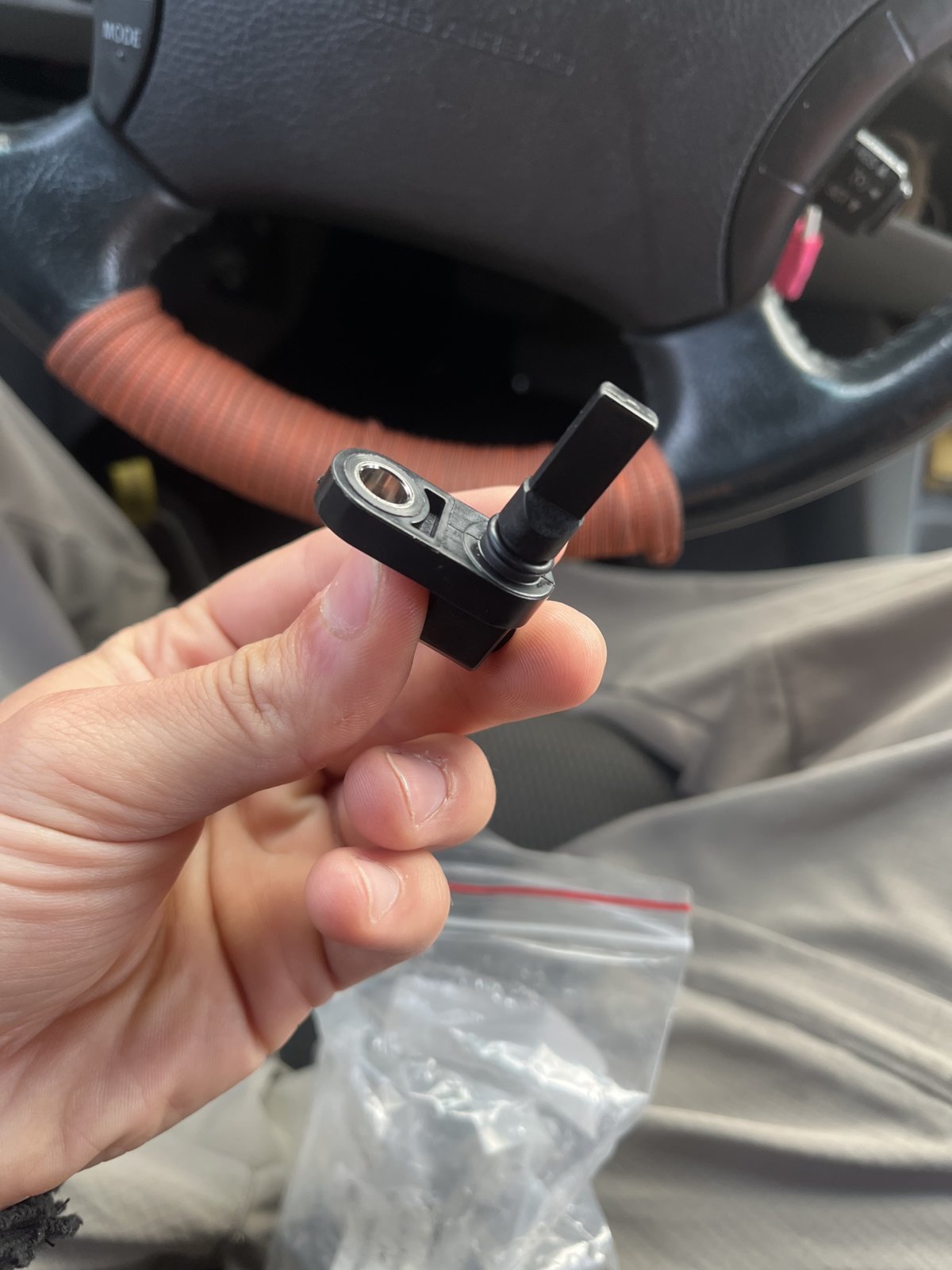

    I tried to go cheap and get a pack of ABS sensors off eBay solve the issue. I found that while they look exactly the same they don’t fit in the ABS hole in which they mount. They make it halfway in and then it gets too tight. It’s right about where it slopes up and gets wider.

    I tried sanding the plastic on one since I have a couple extras and then mounted it, but didn’t seem to fix any of the codes after resetting the abs with my scanner.

    I’m not sure exactly the trouble they ran into but I have a photo of the old ABS sensor (which had snapped off when removing) and you can see that it is not too long.

    As rusty as it looks I bet the hole and area around where the sensor goes is full of rust and needs to be cleaned out before the new sensor will go in.

    Do you have a set of dial calipers? Or a micrometer?
    If so measure the sensors.
    As for the the hole, I used a gun barrel brush chucked in a drill.
    I think I used a stainless steel brush, which can be hard to find unless you go to a place that sells black powered firearms. A brass or bronze brush will work, but it will take longer.

    hey, seems like you were right I just use calipers in bored out with a 25/64 or 0.384 drill bit they now fit perfectly.
