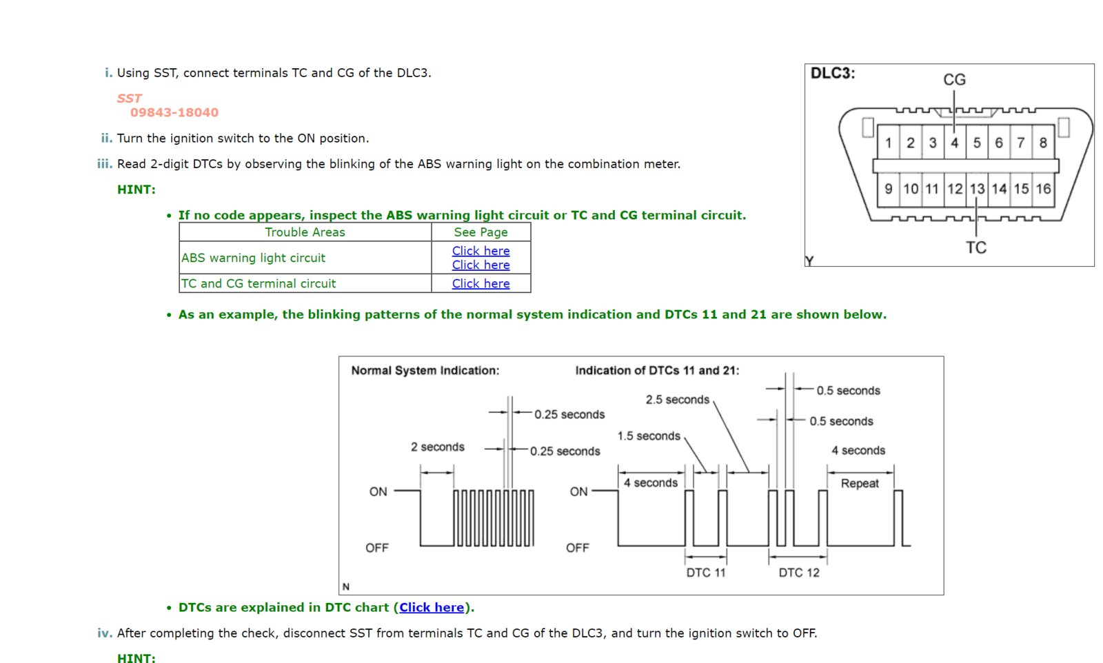

    Just use a jumper wire...it will then cause the abs light to blink in code, write down the number of blinks and then you can look up the ABS codes.
