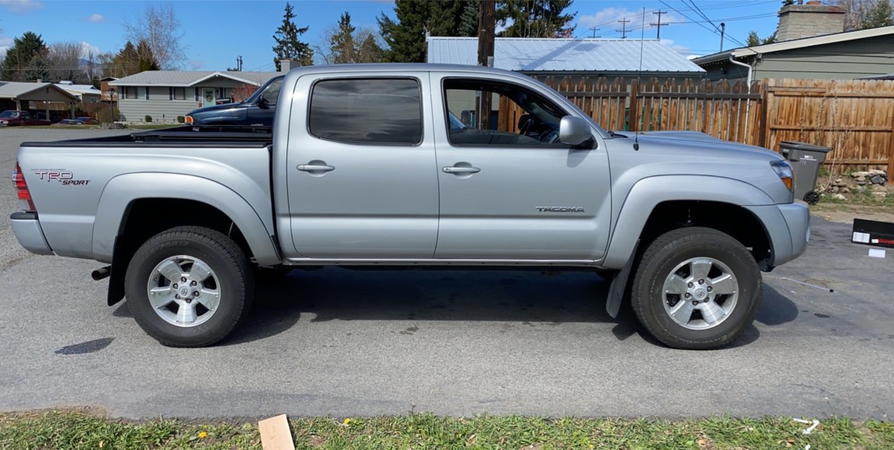

    Hey I just lifted my taco and it looks great. The only problem I’m getting now is that the ABS light and Traction Control light came on. I know it was because of the lift but idk what exactly made it do that, what do you guys think I should do to fix it?
