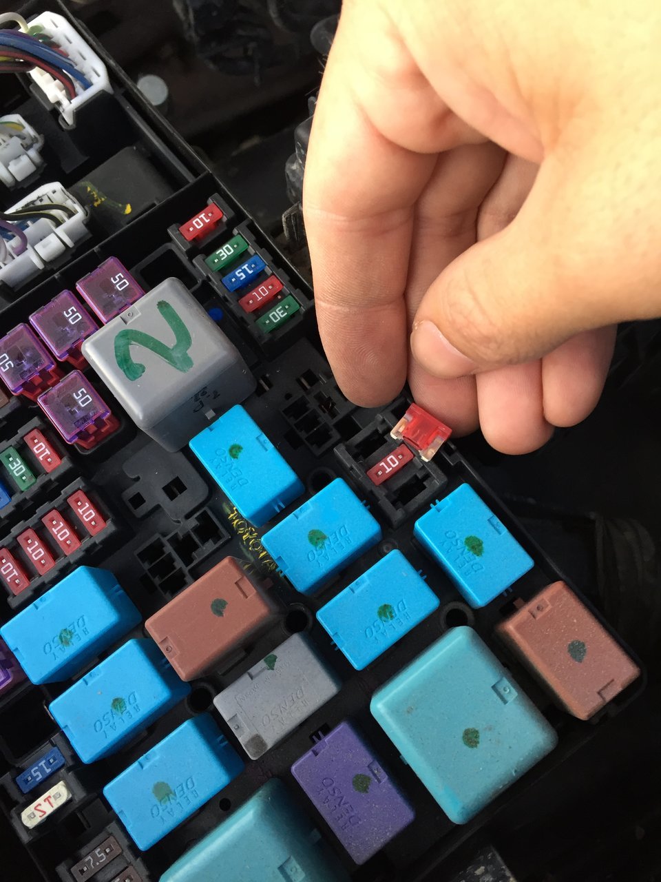

    THank god for this thread. Literally happend to me on my way to work and parked to read what to do and sure as shit couldn’t get it out of park. So fortunately I only had 1 fuse blow and it was a 10 under the hood EFI I think? B63F1F8E-F424-49B1-BD30-98D46FFDB2F2.jpg

    I just had this happen. 10 amp stop fuse blew under the hood.
    Traction control & ABS light on. Wouldn’t shift out of park and no brake lights.
    THANK YOU TW!!!

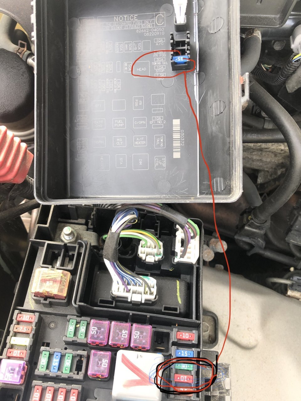

  17. Feb 5, 2023 at 6:35 AM
    #37
    Dana3502
    Dana3502 New Member
    Feb 14, 2021
    #356131
    4
    2009 Red 4-door Tacoma
    I was having the same problem with the ABS and traction control lights randomly coming on resulting in my 09 Tacoma not wanting to shift out of park. I looked at all the fuses mentioned previously in this thread and all were in tact. Finally, I tried one last fuse that is related to the ABS. It's the STOP fuse under the hood. It's a 50 amp fuse. It wasn't actually blown, but I cracked up the casing trying to get it out so I bought a new one. The new one has donut shaped piece of metal making the connection instead of a thin arc. I've had no problems since! Since this was an intermittent issue, I waited several weeks before posting this just to make sure the issue has been resolved. Best $4.99 I ever spent!
