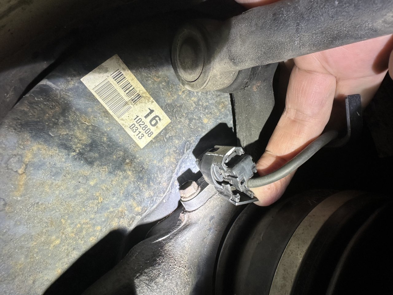

    The ABS and traction light seems to be intermittent.
    The plastic is cracked. Not sure if that is the problem, but either way I need to replace it. What part should I get to fix that?
    For now I have black tape wrapped around it.
    Thanks.
    Looks like this the part I need? Part Number: 8951604060
    Or this one.
    89516-04030
    I am not sure which one exactly.

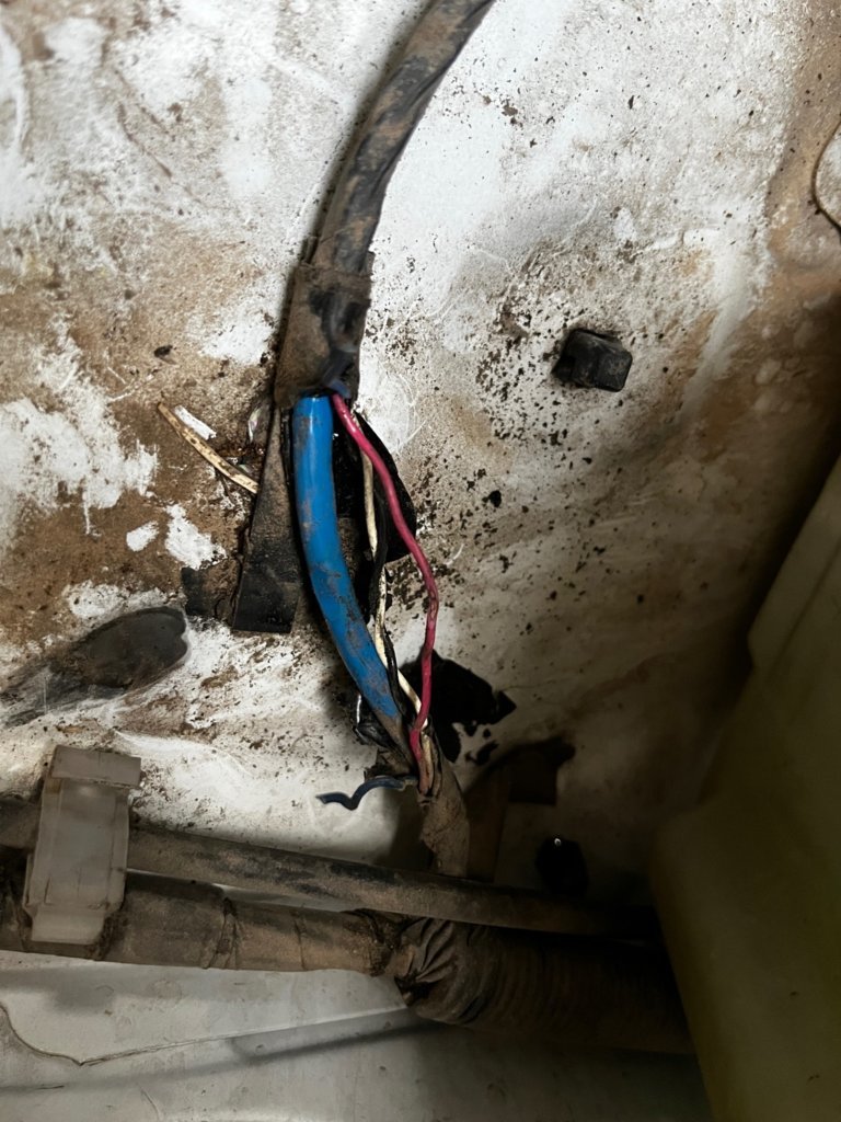

    If you have code C0200, with dash lights for ABS and VSC, and aftermarket air intake, I know how to fix your issue.
    In my daughter's 2010 Tacoma, the previous owner had installed an aftermarket air intake, K&N Filter. Under the filter was the pink wire with copper exposed and the blue wire with the copper completely obliterated. I spliced in a piece of wire. I moved it away from contact with the filter. I removed the toilet seat screw holding the end of the metal intake tube and replaced it with a proper bolt and nuts.
    The dash lights are gone.
