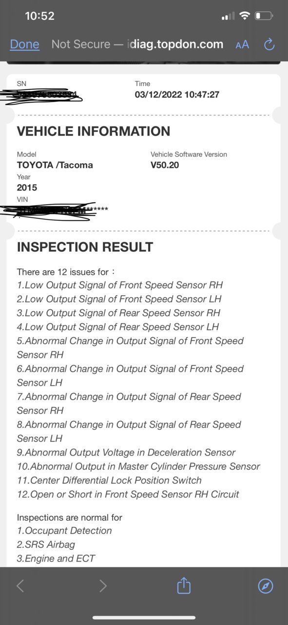

    I just did a suspension upgrade on my 2015 Tacoma and now I have a laundry list of abs codes. I’m guessing the harness or the sensors are faulty but how do I go about locating where the problem is? Do I just take my volt meter and poke around until I find a dead wire or sensor? Or should I say screw it and drop the $200 on new harnesses and sensors for front and rear?

    Reset the codes and continue to monitor. No need to shotgun it and purchase and replace anything.
