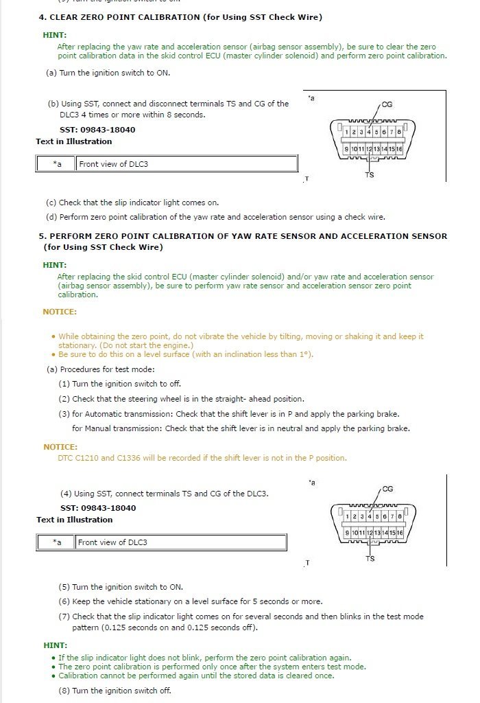

    No codes?
    Did they do the zero point recalibration when you had it aligned?
